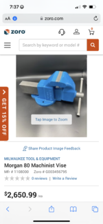

I am looking at an old Morgan 80 vise. 8” no swivel in good shape. Does anyone know if they still make these? I see Zoro advertising them but no where else and I don’t know enough about Zoro to trust their price.
Any ideas on value would be appreciated

Anything over 6in is stupid money. No longer made, but some new parts available.
So is this a fake ad? That is my concern. If
I used that as an idea of what new one coast
I have an idea of what a fair price is for the one I found. Just don’t know

Well I wouldn't pay that, but it could be real based on what a new 8in Wilton lists for (About $3500).
How much is the one on your first post?
The Morgan 80 I found has no swivel base and is $600
