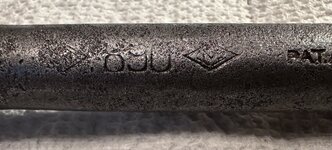

Gentlemen may I introduce you to Frank Mossberg’s last ratchet produced, the 890. I’m figuring late 1920’s about same time as the 851 extention bar. Patent date as far as I can tell was APR 2 1918 which corresponds to a different ratchet. However, exactly 17 years later after patent expired Thorsen came out with M77 in 1935. Indestro and Wright followed years later with the open head / clipped cover design. It kinda reminds me of an enclosed Lane unique 1908 ratchet. This is my first post. I tried to deep dive as much as I could. I found no reference to this ratchet in any catalog or advertisement. Enjoy!
Here's an ad in a 1928 Motor Record for a very late socket set showing a No. 890 ratchet with a loop handle, similar to the handle on their ratcheting connecting rod wrench.
Here's a 1929 Shapleigh cat showing a merchandiser with a No. 911 ratchet.
And, most confoundingly, here's an ad for a No. 911 ratchet - with a No. 890 part number on the shank.
12,052
Nice grab. I saw that rat and thought it was the same one. It looks as though the 890 was also chrome, but it's mostly gone. Note how my 911 has pretty flaky chrome, which may only be a coincidence.
I will say the 890 teeth look even more exposed. Interesting. By the look of the anvil I'm assuming 2 pc gear construction too. Over all they look quite similar. Leads me to wonder if the 911 was a revised version, maybe for the gear teeth, while the catalog could have prior art with the new # listed. Cool either way.
30,914
That was my first thought as soon as I saw the 890. Developed at the same time, for sure, and the catalog with the "890" marking on the handle of a ratchet advertised as a No. 911 is very suggestive.
Your 911 doesn't have any patent markings, correct? OP thought APR 2, 1918 but I am seeing "APR. 8. 1913", which is a Tuesday, but not resonating for me. It may not be a Mossberg patent. Whatever it is, it's oddly nearly a full expiration cycle away from the production of the ratchet on which it is marked.
EDIT: There are no ratchet wrenches with that patent date in DATAMP. According to the Annual Report of the Commissioner of Patents for the Year 1913 there were eighteen (18) ratchet wrenches or mechanisms patented in 1913. None granted on April 8.

Thanks so much. Your deep dives are way more effective. So it’s not the last. Never heard of 911 either. I agree patent date doesn’t match up with anything. If you look at 645 on 1915 and top pic of universal Apr 2 1918 they at least look alike but universal was quite revolutionary in design. Not exactly sure when Thorsen jumped on to making that M77 but it looks like 1935, which was too coincidental for me 17 year patent expiration. Anyhow thank you so much for all your research. Baldy

Well there goes that theory. So the date must be 1913???? Very strange patent date hopefully we will find another with the patent date clearly marked. Thanks for Thorsen reference!
30,914
I don't know what "645" or "on 1915" means here. Please explain. I'd like to review what you say it looks like.
You're right there and can inspect it closer in person, but the marking sure looks like "PAT. APR. 8. 1913" to me from here.
