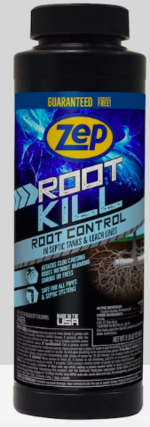

Both zinc and copper will kill the moss....
I have copper on the roof peaks and valleys...
Flattened, the copper measures 8" wide...
Surface of the copper is needed to work...
Wherever the flow of rainwater off the copper misses, moss grows...
As a side note, I have moss growing in certain areas of my yard that gets a lot of shade...
I buy copper sulphate at Lowe's and mix the blue granules with water, and spray the moss...
Kill happens in a couple of weeks... Turns the moss from green to yellow and stops the spread...
This has approx 90% +_ copper sulphate...
https://www.weekand.com/home-garden/article/copper-kill-moss-18012837.php
