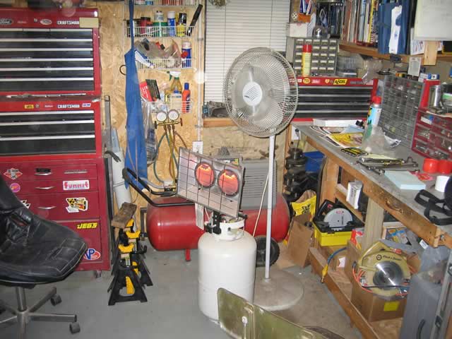

Here's my heater - dual burner Mr. Heater on a 7 1/2 gallon propane tank with a $20 Walmart floor fan.
Works very well in my insulated building. I usually crack the window behind it for combustible air and don't have to run it a real long time.

Propane has its dangers, but no more than any other form of heating, including electric. Get a tank from a supplier, hook up your heater, have the supplier leak test the system, and be warm. Go vented though.
I would agree with that. Vented is the only way to go. Virtually eliminates the hazards of CO (get a detector or two anyway, just in case). Also, there's a lot of condensation when burning propane - that moisture has to go somewhere.
My buddy uses a dual burner Mr. Heater in his barn and likes it a lot.
How old is that green B&D circular saw under the bench? I miss those old saws.
