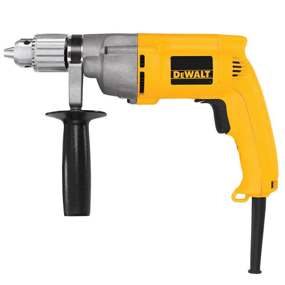

My current corded drill is pretty weak so I just picked up a 10 amp Dewalt and will probably just use that.
Current (amps) does not always tell the whole story. You should have gone with the DeWalt DW245
The 7.8 Amp DW245 Drill with 600 RPMs provides contractors with a powerful drill particularly good for large hole drilling. The drill includes helical-cut, heat-treated steel gears for long life and durability. The two-finger, rubber trigger provides increased comfort and the drill includes a 360 degree side handle for greater control and versatility. Triple gear reduction provides increased torque and reduces gear stress. The drill in composed of metal gear housing for jobsite durability and reliability. The DW245 drill includes a 360 degree side handle and check key with holder.
• Helical-cut steel, heat-treated steel gears for long life and durability
• Metal gear housing for jobsite durability and increased reliability
• Two-finger, rubber trigger for increased comfort
• 360 degree side handle for greater control and versatility
And you had better use that side handle when using large drill bits !
