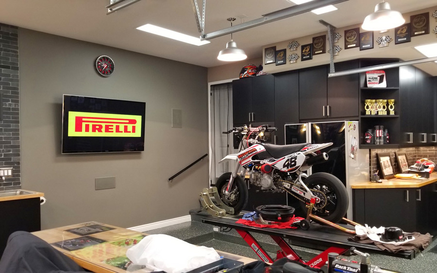

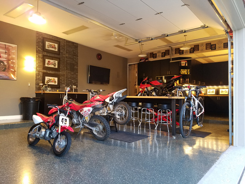

In the meantime, a few random photos from the garage recently ..
A couple extra bikes housed at the moment. One being a borrowed CRF-50 my son has started riding at an outdoor kart track. Has been extremely cool to watch him enjoy riding.

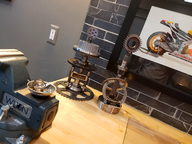

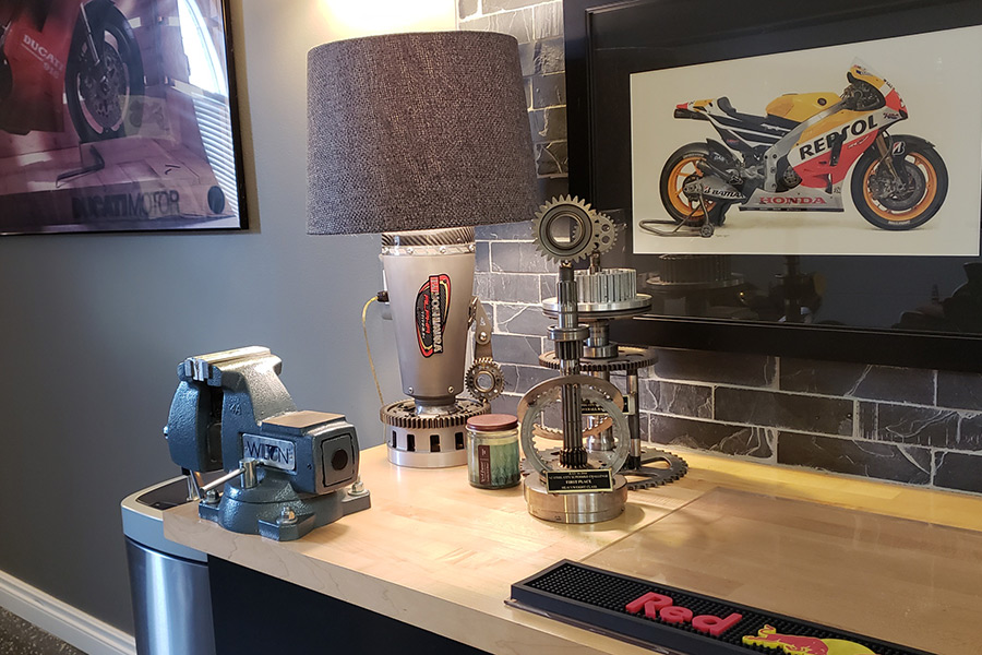

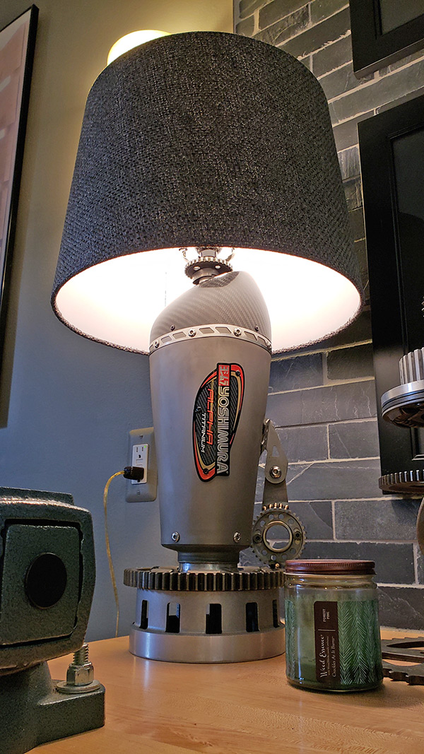

Sold the R1 at the end of 2017, had a few "trophy" pieces that were converted into a lamp. Final lampshade still TBD.
Yoshimura race exhaust, clutch basket, cam and other parts. All of them in "lightly used" condition.

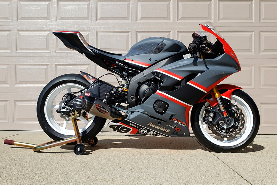

Following this project and then the sale of the R1 in 2017, we went back to an R6 for this year. Build process was similar to other bike builds. Garage certainly did its job.
Aftermarket subframe, among other things.
Finished product.
