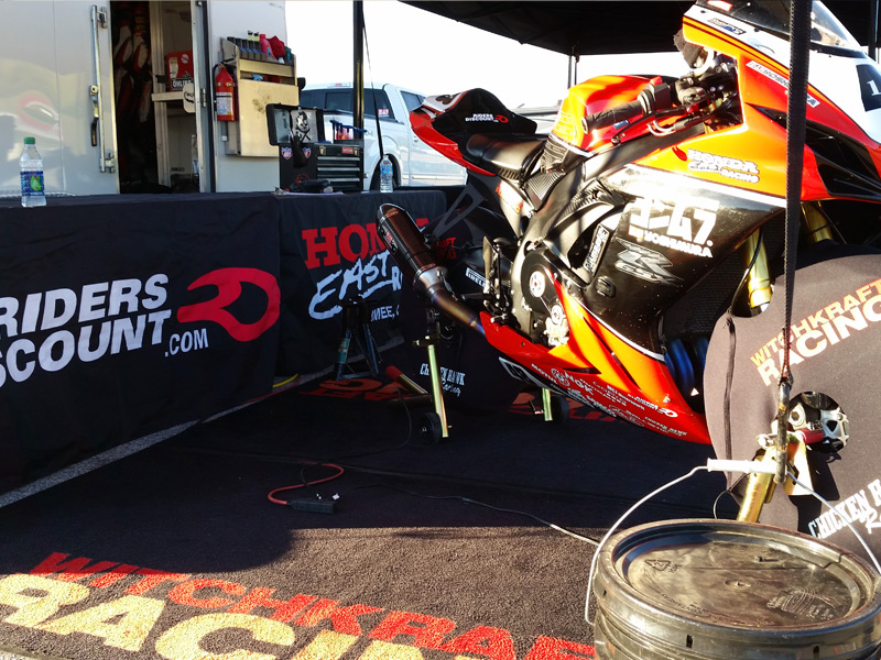

Here are a few random photos from the end of this past season, down at Barber Motorsports Park. Figured it had been awhile since posting race photos.
Early morning. Practice, then time to go racing!

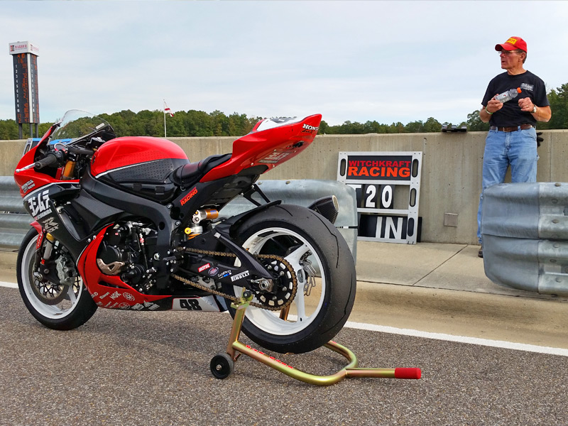

On pit-road during a red flag. Dad deep in thought:

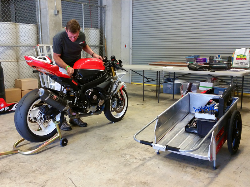

Post-race teardown in the tech shed. We passed.

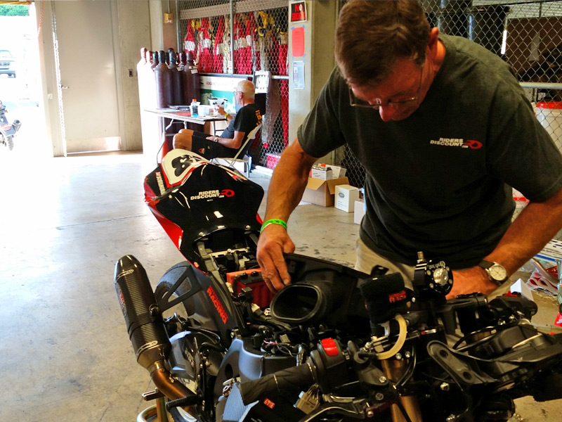

Putting the bike back together.

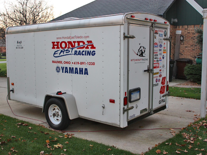

Hey ekraft, how about a few shots of the race hauler. As well set up as your garage is, I'm sure the trailer is just as nice. Getting my little 6x10 ready for WERA this year. I know pretty much what I want to do, but I'm always up for any new tips to make the little trailer as efficient as possible.

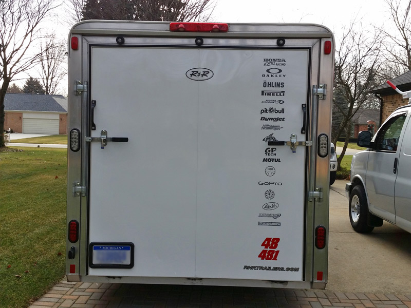

sbhockey, I took some photos of the trailer this past weekend. It's nothing like the factory rigs, but it works well for our purposes. For years, we traveled in a 6x10 trailer, stacked to the brim - with a specific order of loading and unloading, for everything to fit. After awhile and as our program grew, it just became too small for our needs.
So a few years ago, my dad spent what seemed like days drawing up plans on grid paper for this trailer. R&R Trailers built it. It's aluminum and 7x19 in size. Some pictures below:

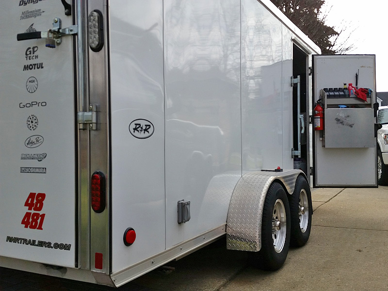

Ramp door in the back for loading and unloading things with wheels:

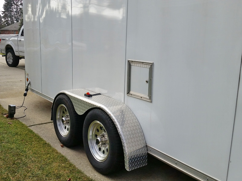

Dad ran three sets of plugs (one shown in this photo) along the side of the trailer for tire warmer hookup. This way, we power the trailer with a generator on the opposite side (away from us) and can run three sets of warmers independently, without extension cords everywhere.
Opposite side. Note power hookup towards the front, where the generator typically plugs in. My dad ran power from the house, over to the hook-up in the ground shown here, so the trailer is powered when parked in the driveway. The little lock-door on the side is for fueling race jugs. When at the pump, we open the door and fuel the jugs inside the trailer, without loading and unloading them every time.

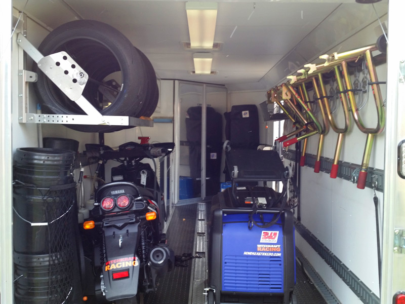

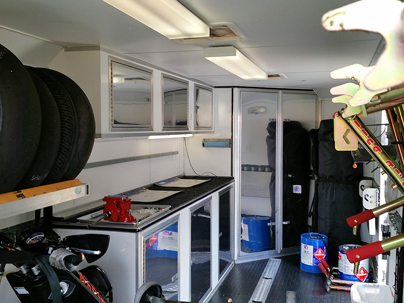

Inside. Cabinets, tire rack on the left, and racks on the right to hold the Pit Bull bike stands.

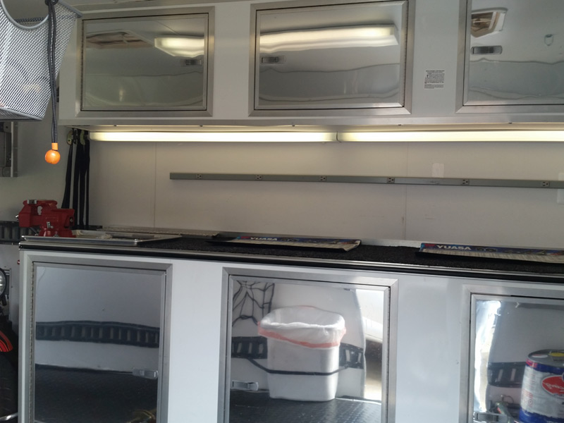

Up close on cabinets. Plug-strip, under-cabinet lights and vise/mini-work bench. Good for changing shock springs or quick-fabbing parts after an off-track excursion.

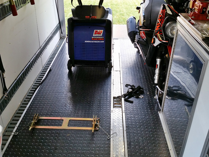

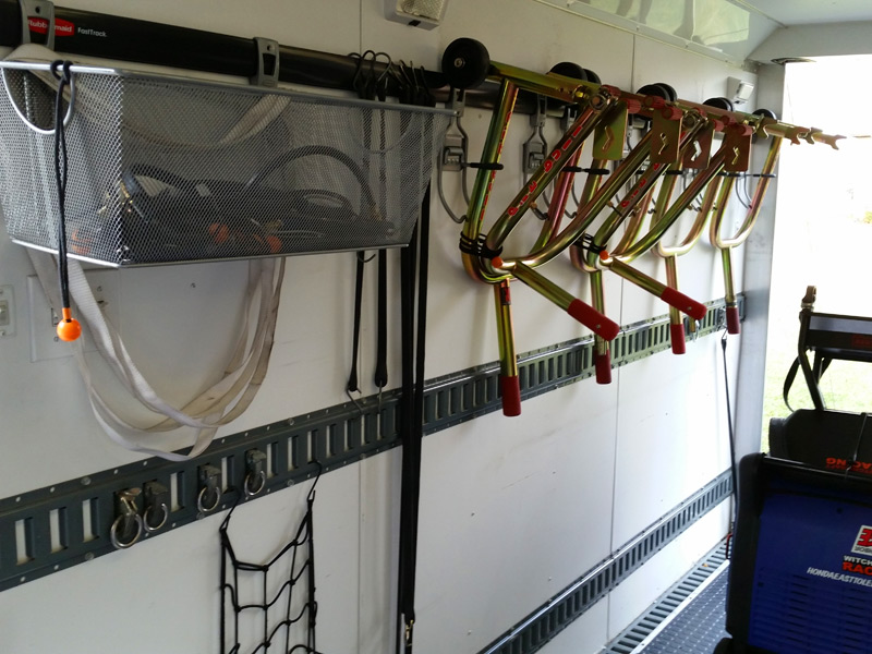

Dad wanted e-track everywhere to make tying anything down a quick and easy process. The metal bin just houses tire gauges, trailer restraint pins and other miscellaneous items.
Pit Bull Trailer Restraint System shown on the floor. We have one for each bike. No more tying down bikes by straps, stressing the suspension - or checking on them during a trip to make sure they're still standing. Just clip the bikes into them and done.
The bikes stay on the right side, with the generator sitting off to the left, in between them. The Zuma sits on the far left, under the tire rack and alongside the fuel jugs.

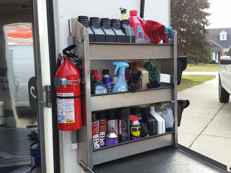

We carried this piece over from the old trailer. A good way to store everything from brake cleaner to WD-40. Fabreze too.

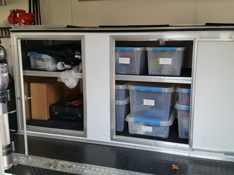

We use these storage bins throughout the lower and upper cabinets. Basic organization. The far right cabinet has a series of parts drawers (not shown) for nuts, bolts, master links, alum., etc. etc.

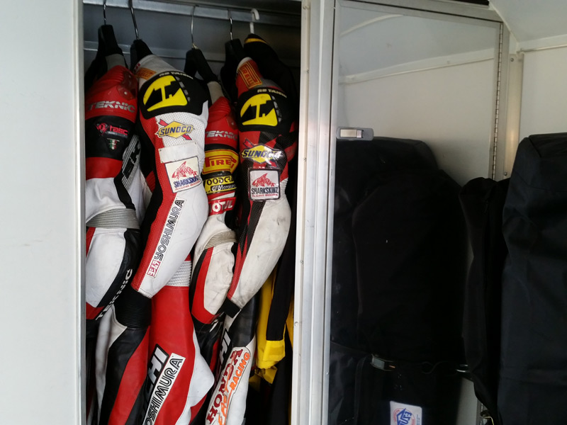

This is the front cabinet. It's a full-height cabinet and wasn't originally in the plans, but once the trailer arrived, we realized we needed something up in the "V" part of the trailer. The left side has leather suits as shown, along with helmets, boots and gloves off to the far left. The right side cabinet has our spring compressor, along with banners, chairs, tire carts and other odd-shaped items.

Looks great, what are you using to secure the pitbull stands to the wall? Been looking for a clean solution to store my stands

Oooh, I haven't seen those kind of Rubbermaid FastTrack Bike hooks before!
I'm using these (P/N 5E02) for front and rear stands (the compact hooks for single-sided swingarm stands):
The tire support is neat though! Is that an older model? It doesn't have the clamp handle they like now. I can imagine it helping keep them in place a bit - particularly in a trailer.
Rubbermaid FastTrack, as afm mentioned. Although I think they are discontinued. There have been a few people interested in that setup since seeing it, but I think one guy told us he couldn't find it anywhere, after looking.

That clamp handle looks nice on your image. We haven't had any issues with the stands moving during transport, knock on wood.

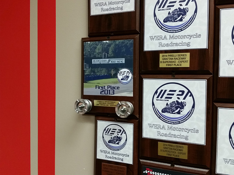

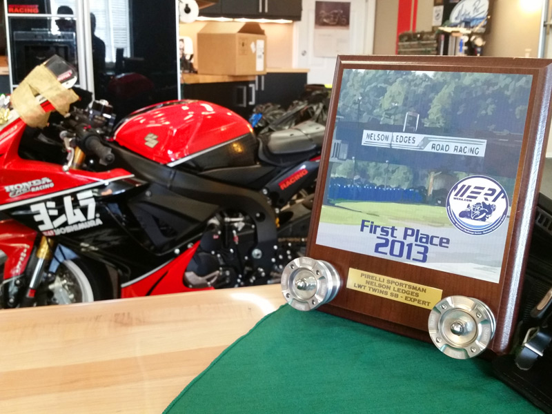

My dad put together a great gift. A coat hanger. Made from one of his old plaques, along with two Ohlins 30mm cartridge fork caps, I've never been this excited over a coat rack before, but it was needed.

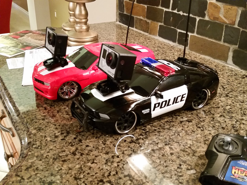

Santa brought our 4-year old a couple RC cars for Christmas. I proceeded to put a couple GoPro's on them. For $29, it was tough to go wrong.

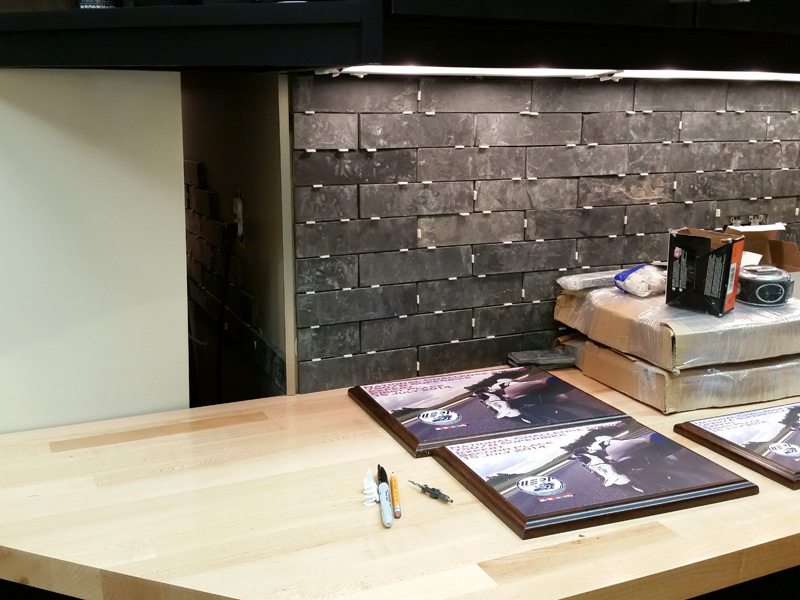

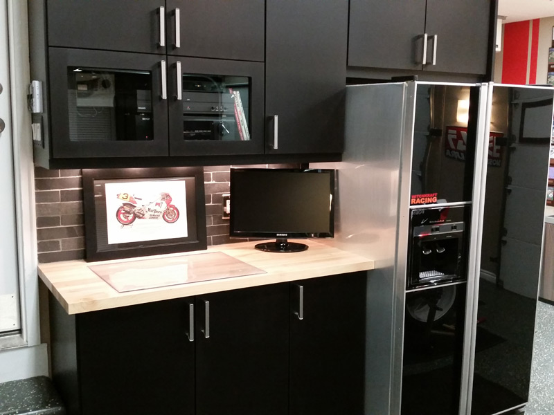

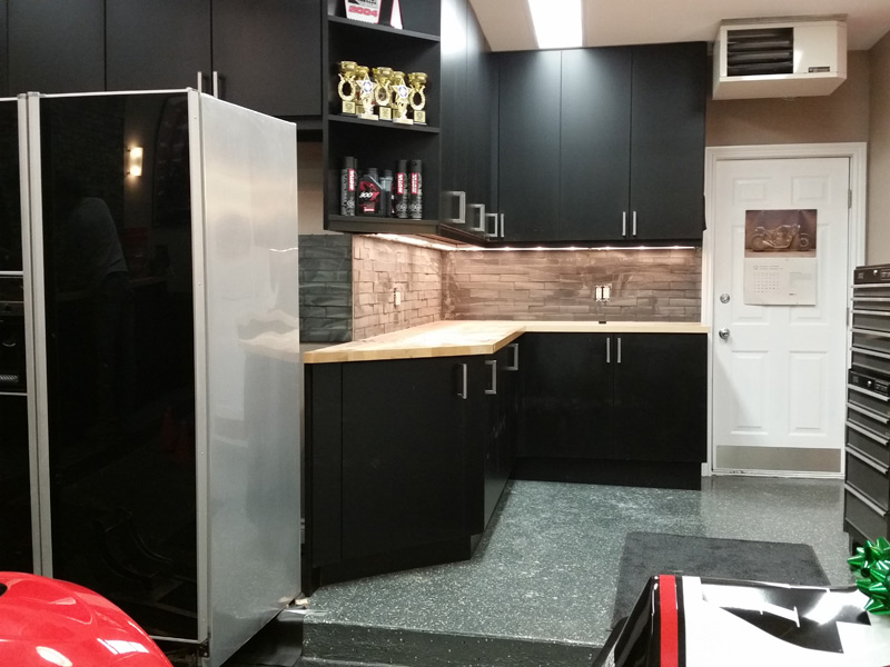

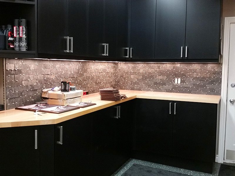

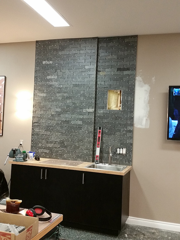

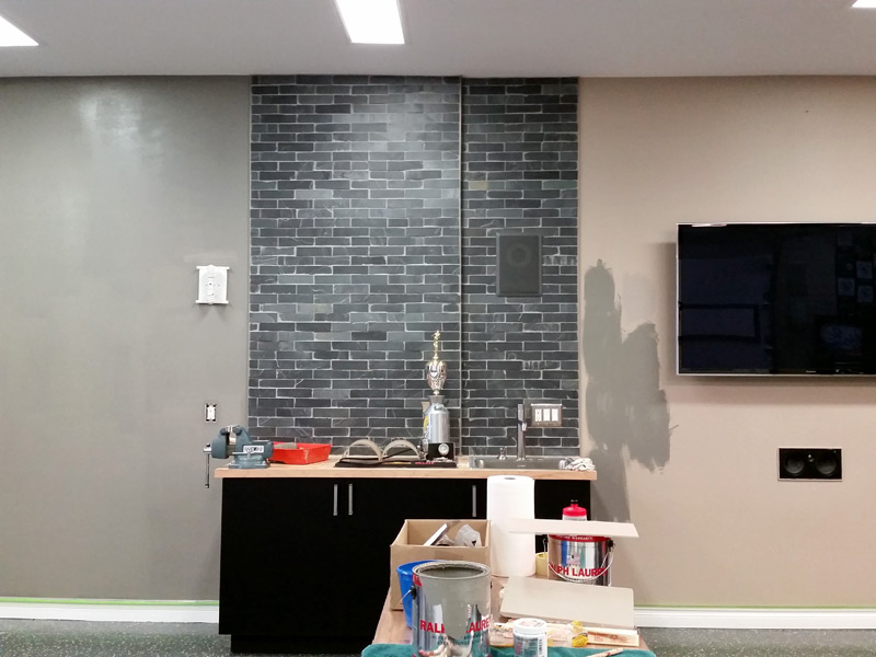

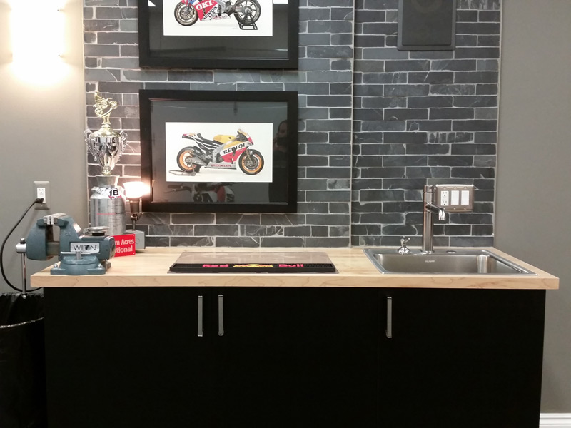

Finished up a couple other things recently, the backsplash being the biggest thing. I had been lazily looking for something grey for awhile but it seemed simply too absurd to put a backsplash in a garage. However after thinking about it long enough, I found a way to justify the need. Plus, after doing our kitchen I found the exact stone I was looking for, which didn't help matters. Below are some photos of the absurdness:
Grey subway stone tiles w/spacers installed, pre-grout.
The metal edge piece is shown here on the corner, to make for a clean transition around the wall and behind the fridge.

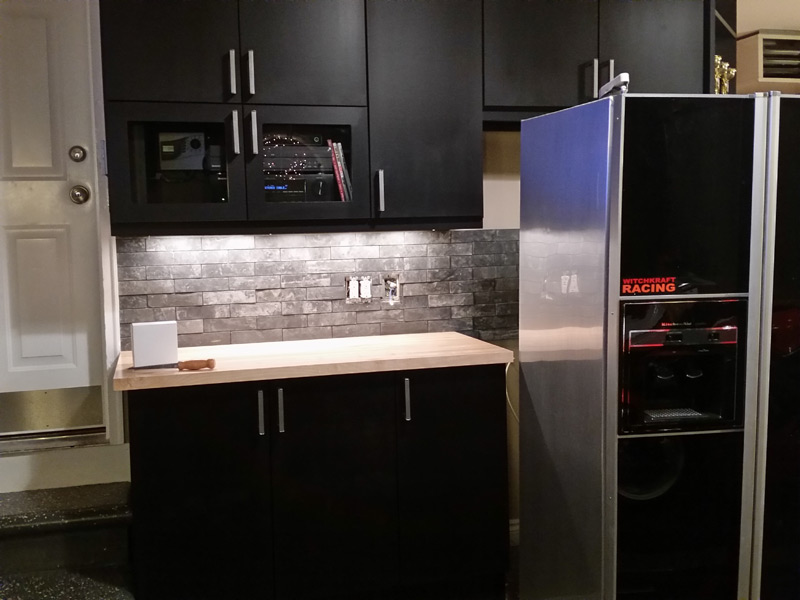

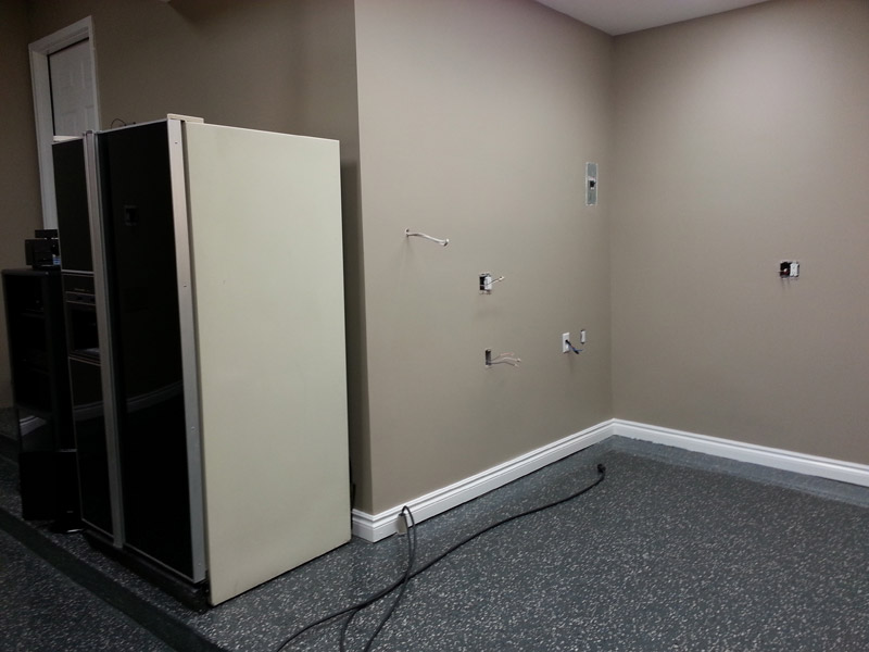

Flashback photo, with the old off-white sides of the fridge ..
I took some "stainless" looking vinyl and cut/applied it to both sides of the fridge. Cleaned it up and made it look not so old.
Grout complete on the tile.

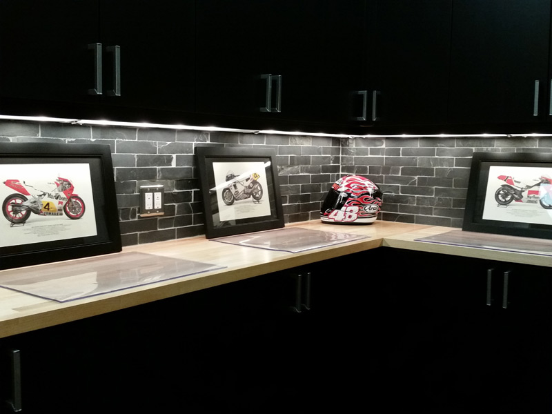

The plan was always to have a backsplash around the sink, but with that wall being so wide and tall, it didn't look right going up only 12-18". I thought running it all the way up the wall would break it up and look a little more complete. A buddy suggested putting a fireplace in the wall. Now *that* is absurd. I think.
Grouted, sealed (natural, nothing to make it any darker) and finished.
Another angle.
In the midst of this backsplash phase, cabinets have been slow-going, but moving along - as well as some ideas for a change of color ..

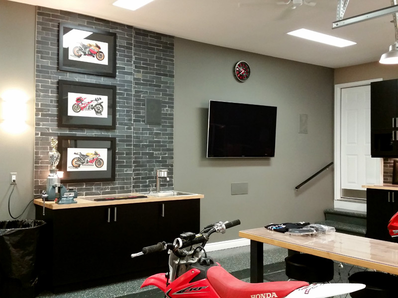

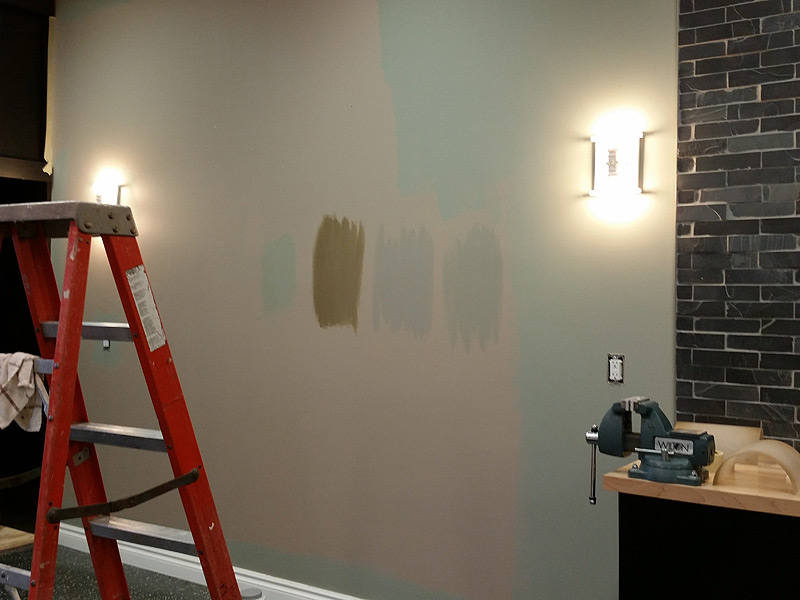

After the backsplash, the color of that wall was to change. My wife offered to help, so that meant things were automatically a go. She has a great hand when it comes to doing trim, where no green or blue tape is required (except for along the bottom trim, mainly for catching paint on my roller-usage). So over the course a couple hours, we hammered out 211 sq. feet of paint. However ..
This was the color we first tried. At the store, it looked grey, not green. Here, it looked like we were painting ourselves into a fish tank.
Several samples later, we settled on this.
Drying a little darker, it has a grey, putty-like look to it, which blends well with the tile and keeps a touch of warmth, without being too "cold" of a grey.
Painted the plates to match and matched the tile to a small sample-size of paint to get the in-wall speaker to match the color of the tile. Also swapped out all the backsplash electrical plates to a stainless/nickel, to match the cabinet pulls.

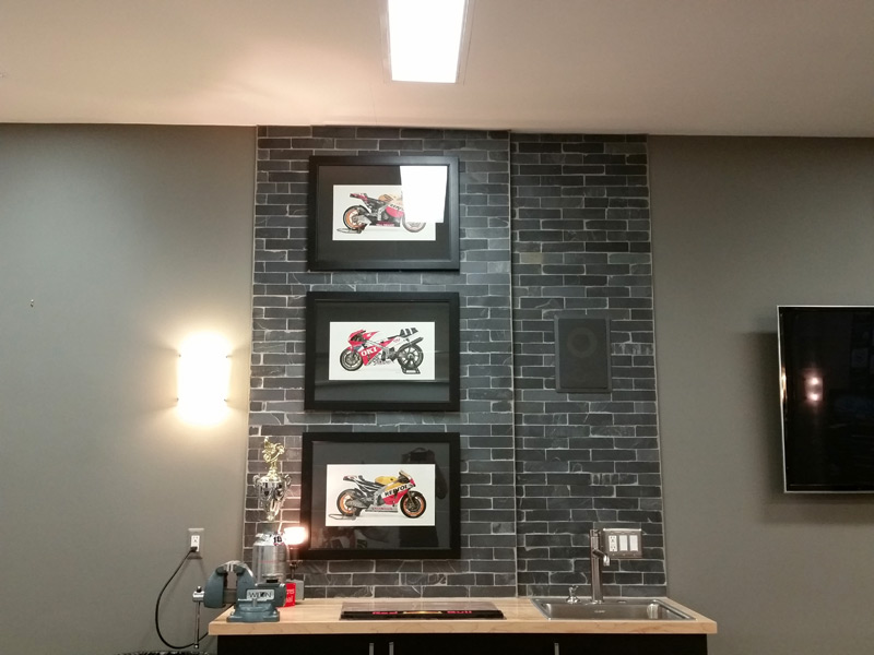

Three new prints from Superbike Planet mounted on the tile. Slightly bigger and better-spaced. The five prints that were originally hanging there now need to go somewhere else. I'm thinking on the face of the full-height cabinets, once complete. The motorcycle prints have sort of become a theme of the garage, scattered throughout.
Added another row of plaques to incorporate the coat hanger-gift from my dad..
Ready to hang coats.

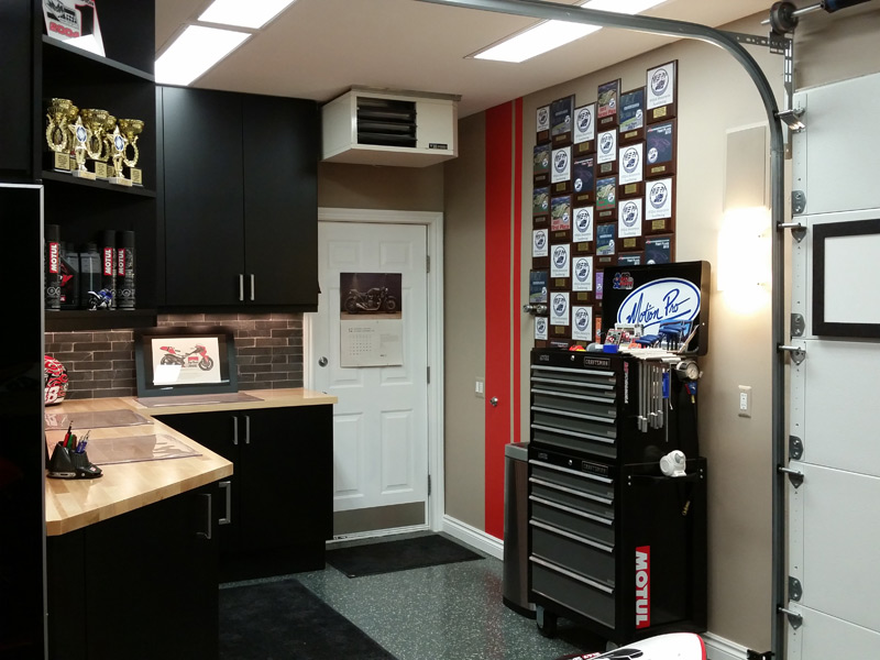

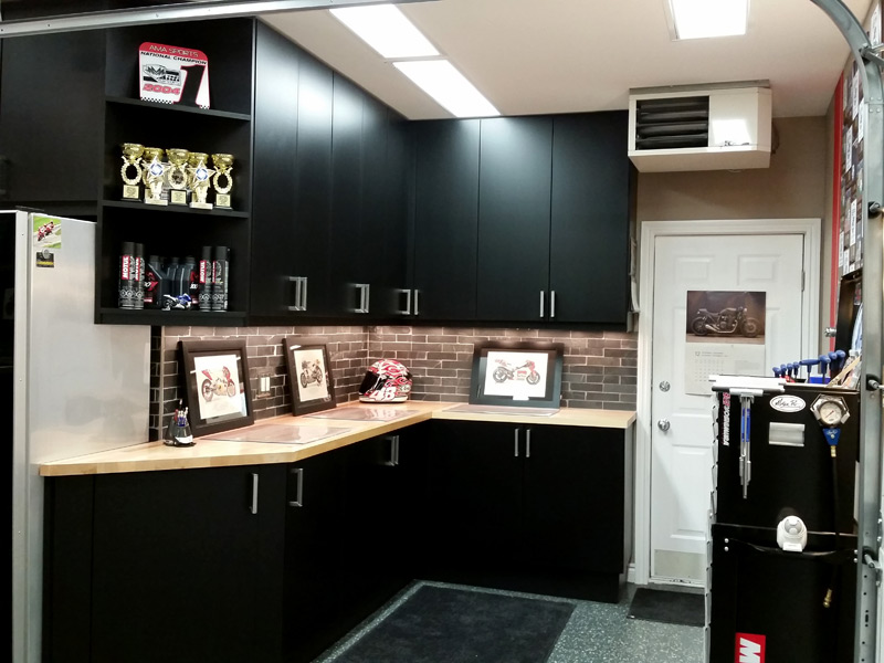

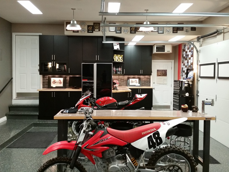

Finished shot of the area to the left of the fridge.

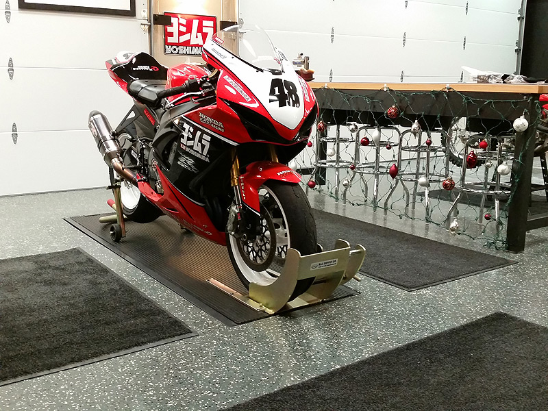

The garage is too clean for this time of year.
We're sort of in limbo right now with our plans for the upcoming season. This bike (Abbey) has a deposit to a new owner, but we can't move forward with things until the sale is final. It's bittersweet, as this has been a great bike. The second bike (Bridget) is currently at my dad's. He was sad not having a bike in his garage. :)

Holy ****! The addition of the tile is spot on! Great new texture/colour addition to your space. BTW that trailer looks great.
Thanks dubber. Much appreciated. Texture was what I was looking for, with smooth drywall and cabinets taking up much of the space.
