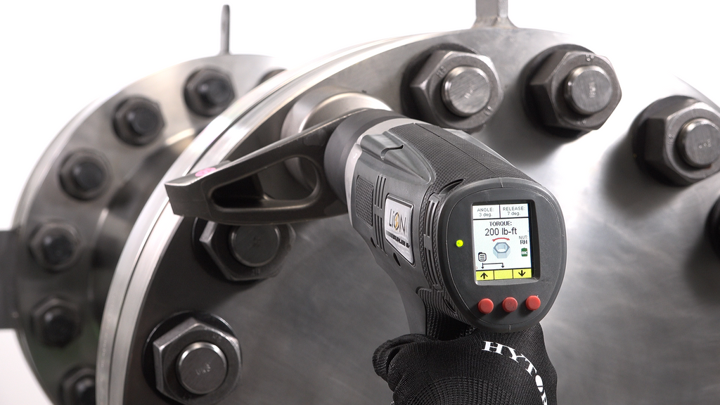

Can someone please recommend a motorized electric torque wrench? A tool were you input the torque value you want to tighten the fastener to, and then pull the trigger, and it automatically torques the wrench for you via a motor to the specified torque. No manually wrenching with your hands to the specified torque.
I know of for example that Milwaukee makes two, 2465-20, https://www.milwaukeetool.com/products/2465-20. But at $700 it's not really economical and doesn't make sense over just using a manual torque wrench. I know there's also precision bolting systems that costs a few thousands of dollars.
These tools have like timestamped digital records that can be stored, can connect to Wi-Fi, etc. I don't need any of these futures. I just want a motorized torque wrench that can automatically torque fasteners for me. I don't need or want any of all these other additional futures like timestamped records. I was hoping I could find one that didn't have all these extra futures for cheaper, but I don't think one exists?
I was hoping maybe someone on here knew of a more economical one that was more affordable?

As stated the Milwaukee one is the “cheap” option. The one I have at the day job was $7k and only gets used by those I deem responsible enough to use it.

The Milwaukee isn't very accurate as it's an impact. It just gets you into the "ball park." The good ones $$$$$$$ are very low geared drills that mimic how you use a torque wrench by hand meaning a slow steady pull or in this case rotation.

Hytorc Lion Gun. They ain't cheap though. They require a torque arm/some sort of mount to apply torque against. I have no experience with them though, just seen em on YT.
I heard the M12 one ***** for accuracy. Again, no personal experience with them either.
