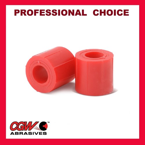

I recently got a 10" pedestal grinder that came with a 10"x1" stone mounted on it. I removed the stone for safety when function testing the machine, but when I tested the stone and decided to reinstall it I discovered that the spindle diameter of the grinder is only 7/8" while the stone has a 1" arbor and no spacers. The mounting washers are flat-faced with no flange. When the stone was previously installed it was perfectly centered on the shaft-how was this done?

Any method to do the above is BAD SCIENCE! An exploding 10" stone would be akin to hand grenade going off at belly-button level.
Having said that, one could do it by loosely tightening the washers, rotating the stone by hand and checking the runout with a pencil. Where the pencil hits, tap the stone with a rubber hammer to move it until the pencil line around the stone is constant, tighten the nut and true the stone with a star wheel. Do not try this at home!

You need grinding wheel arbor reducing bushings (sized appropriately for your application) similar to these:
Any other method is risky IMHO.
