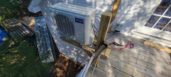

The bonus room over my shop was too high to mount the outdoor unit to a pad and I did not want to leave it sitting on the entrance deck. So I fabricobbled an extension off the side. I through bolted the 2x4s to another 2x4 that spans three joists in the platform. Added a few knee braces and cross braces. Put a piece of rubber between the vertical 2x4s and the ones the unit is mounted to and then the isolation pads that came with the unit. The double pads seem to have eliminated almost all vibration getting transferred into the shop.
I initially ran the AC w/ the outdoor unit on the deck and it sounded like someone was cutting the grass outside when running and no isolation pads.
Hoping the support holds up, it held me and seems to be sturdy enough. I can always replace w/ metal if needed. The wood was drops from the recent deck build.
