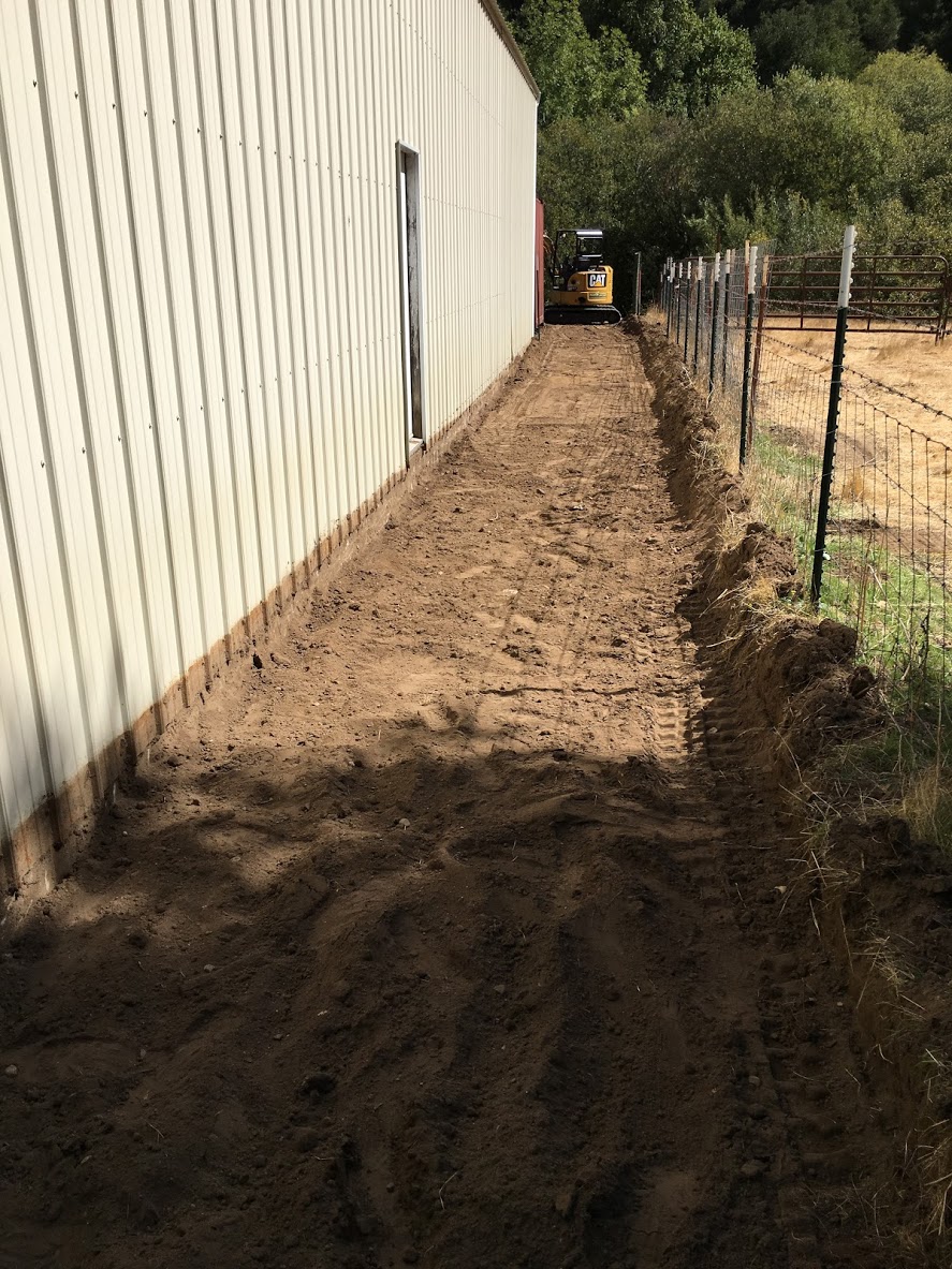

Z
zippyslug31
Jul 11, 2017
207
Central Oregon
Back to to the original idea- mice will dig through sand like crazy. I would backfill with large gravel. Small enough that they can't wriggle in between the stones; big enough that they can't easily move them. I've read where the right size material is an effective termite barrier for the same reasons. Obviously, a mouse would need much larger size material than a termite, but you get the idea. The gravel won't hold moisture against the building like sand will. It's either that, or bury galvanized wire cloth.
Gravel doesn't work; I already know this. I have compacted 3/4-minus under one of my doors and they still burrow through it over time. As I've indicated, I do have traps set around this (and other) door openings.
Can you elaborate on your experience with mice digging through sand like crazy?

I had a pile of sand in the front yard while I was doing stucco, and it had holes in it, and I saw a mouse go in one of the holes. I don't know if he dug the hole or not. Wet sand won't collapse like dry sand will.
Perhaps 3/4" gravel isn't big enough?
