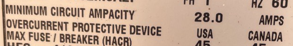

Here's the label from my Trane 4ton unit:
It has a unfused disconnect, just like every other hvac system I have ever seen in person in my life.

Does that email from Mr Cool not literally say unfused disconnect in your thread?
PCustoms
Jul 23, 2011
23,692
VT
Yep, and what was the ultimate response based on the equipment label, verified by the electricians?

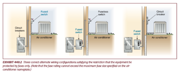

Went and downloaded the NEC handbook off the **** web. Nothing says integrity and public safety like putting our laws behind paywalls. But anyway, here is what I found:

I’m sorry I started a thread that became unpleasant. When I spoke to my electrician he said as long as it is connected to the correct sized breaker an unfused disconnect can be used.
The two posts above yours literally cite the NEC code that prove your electrician wrong.
Glad you chose to use a proper disconnect, but it's not about feeling better, it's code
