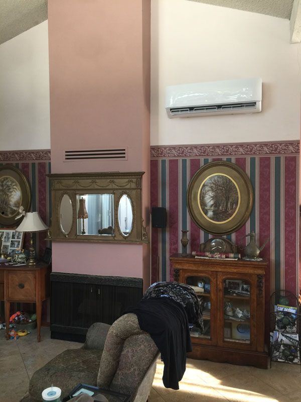

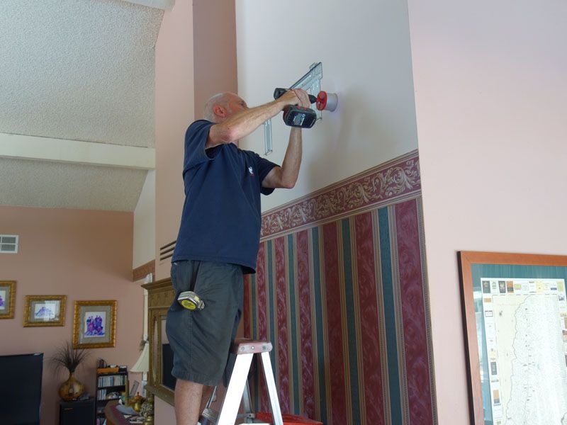

Browneye
May 29, 2018
311
So-Cal
Harbor Freight...LOL
About the hardest part of my install was drilling through an inch and a half of stucco - it's like concrete. HF had a carbide hole-saw kit for like $30 that had a 3-1/2" cup. Worked perfectly and sawed through that stuff like butter. Great for sheetrock as well - bonus.
The next difficulty was standing ten feet up on a ladder while holding the air handler and trying to feed the lineset through a hole in the wall. Shwew!!!!
The wallpaper top border is at 8'. LOL
jjrbus
Dec 8, 2018
635
Florida
I had to go through 8 inch concrete block and then 1 1/2 inch of stucco! I used the long carbide 1/4 inch drill from HF to line up the holes, then the HF hole saw from both sides!
