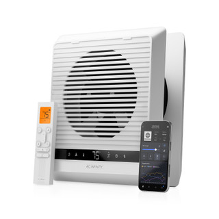

I just bought another 9K BTU unit for the back bedrooms. It's almost in...my cement drill bit wouldn't drill, so waiting for the rain to stop now so I can finish hooking it up. Air handler is hung, wiring is done - had a spare 20A breaker in the panel, and the unit sits right in front of the electrical panel, so running wire was a matter of pulling thru and elbow into the main panel. Super easy install on this one.
I want it to cool both back bedrooms - they are small 10x11 bedrooms - so I got one of these room-to-room fans from AC Infinity - it's way cool, super quiet, will push 160cfm on high at 20db, and has a thermostat for heating or cooling. 6x12 inches - $80.

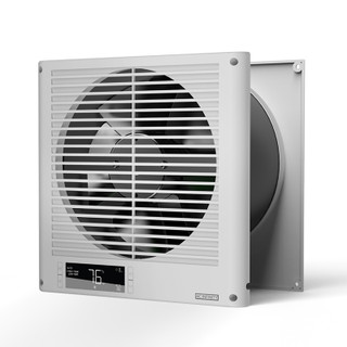

I returned the AC Infinity register fan I posted above, as the one I really wanted came back in stock.
This one is 120VAC instead of 24VDC, it pushes up to 303cfm at 48db. It's a lot nicer more powerful unit that can easily be hardwired, for $10 more. And it's double sided so I don't have to mcgyver a vent on the other side of the wall.
I just love these guys - they make really great products...no affiliation:
