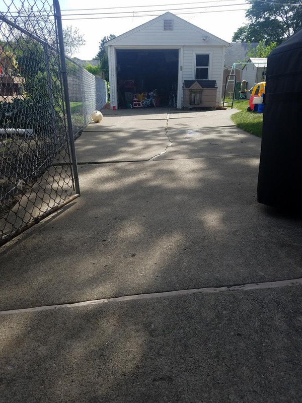

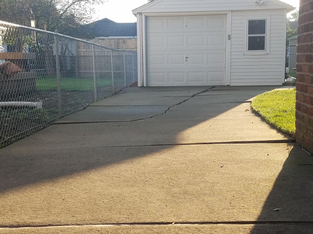

I'm starting to get quotes to level out the driveway slabs that go from the backyard gate to the garage.
Theses slabs are at least 40 years old and have been in this condition for the 10 years I have owned the house so I think they are pretty much settled. I have one crack right down the middle of one slab that is wide enough they should be able to be lift it without it binding up (if not I will cut the crack out). They formed these with boards then left them in.....which I have seen at a few houses in the neighborhood so the stupid process must have been an option at one of the companies back then, toward the garage they left in two boards so it is like a 4 inch gap between slabs. I didn't bother me too much but now that we have kids it is more of a larger safety issue.

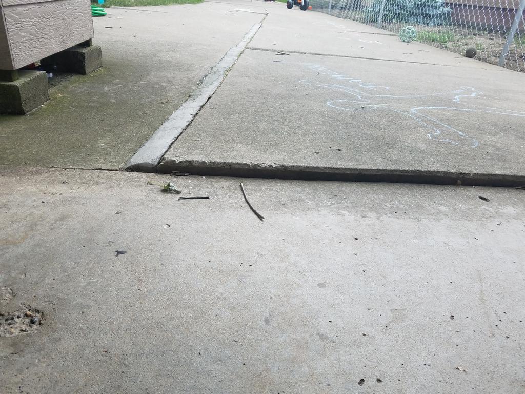

My issue is that with meeting everything with the high side at the garage I will be dealing with a 1.25" lip at my garage that will make it a pain to roll out a jack, etc. The garage floor has a crack so I don't know if it would be possible to lift the garage to match the driveway and I would assume that jacking up the entire garage would be costly and create more potential issues than it is worth.
So the big question is.......what to do with the lip at the garage?
I thought about cutting out a foot or two of the driveway and pouring a new piece to bridge the gap but then would have water running toward the garage so I'd be fixing one issue while creating another. Grinding seems like It wouldn't be an option because it would have to be brought out several feet and over 25% of the slab depth would be compromised. I was thinking of maybe scoring the concrete on the garage side and troweling on some epoxy "concrete" like MG-Krete to keep it level to get into the garage and then ramping it down.
Before you say "I'd just rip it out and repour", that would be my advice too if I didn't have to pay for it but I can't justify that right now, partly because I'd also have them pour a small patio, replace the sidewalk, and add a small walkway next to the driveway in the front of the house which would get my bill closer to 10K.
First company is coming by on Tuesday and I think I'd like an idea of how to deal with the lip before they point it out as an issue. I'll take any thoughts. Thanks.

Hard to tell without measurements. In the pictures nothing (including the garage)looks square, level or even. The various sections of the slab appear to be slanted different directions.
There is a chance that if they jack the far end the end near the door will drop.

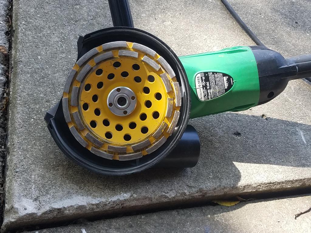

I invested in a used 7" grinder/diamond wheel/vac shroud for the larger lip at the garage.....this thing eats concrete for breakfast (the edge next to the grinder was ground for less than 2 seconds and I was shocked at how much material was gone):

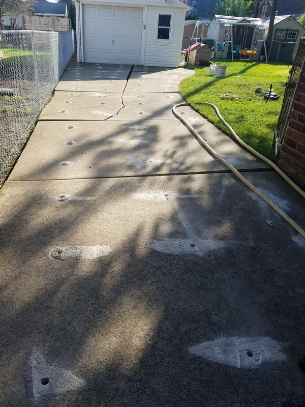

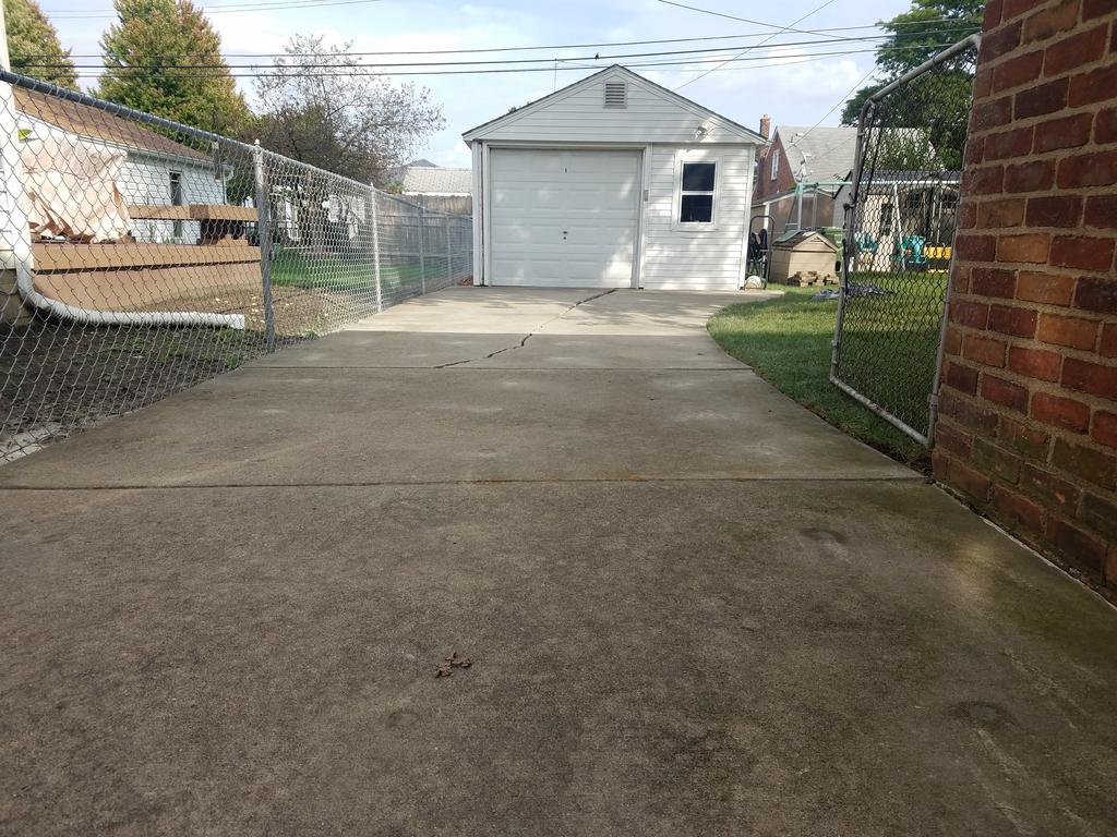

Well today was judgment day.
Before:
77 holes drilled:
After:
The guys were shocked at how much lime the job took, there were no voids but just a lot of adjusting. I'm 100% satisfied with how it came out and feel like a jackass for not doing it years ago. 4 year warranty so we shall see. Now I just have to fill in the large seam, grind the 1 inch by the garage, and caulk everything with self leveling.
