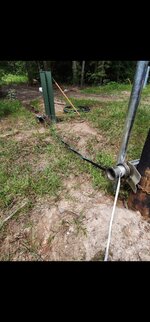

Finally got my wire pulled in yesterday. Woohoo!
Went really smooth. It only had one 90 which I'm sure helped a lot.
So I guess the muletape was accurate enough.
Ended up using 385 feet of wire. I bought 400 ft but from the looks of it I got a lot more as the footage markings on the wire indicates 502 feet.
I think the guy rolling it on the reel must have lost track. Idk.

Did you check the markings on the original spool you got? Would kind of **** to have bought the second one if they overshot the first, too

Even if it started at zero eventually it gets cut. So you always need to record the starting number and subtract from the ending number.

Without unrolling it i can't see the footage on the tail of the wire where it co.
comes through the hole in the reel.
