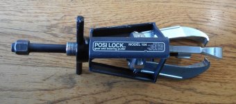

50 years a shade tree wrench turning, I have NEVER had access to a puller of any kind ! One large enough to pull rotors or drums would have been useful at times, but I managed to get the off via other means !
