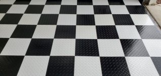

This Covid19 crisis has given me lots of time to get projects done around the house. I spent last week in the 3rd car garage gets things cleaned up and organized. I also spent some extra time getting my RaceDeck floor in this space cleaned up and detailed, and I thought I would share the results with my GJ friends.
My daughter and I installed RaceDeck flooring in our 3rd car garage in 2007. The flooring has held up really well and I still love it 13 years later. I use this 3rd car garage for my "fun" car and for all my tools and projects.
After 13 years of use I figured it was time for a detailed cleaning. Over the years I have always kept the floor swept out and occasionally I would hit it with a wet mop. It was time for a deep and detailed cleaning. I spent about 8 hours on my hands and knees scrubbing each and every tile with Purple Power (a degreaser that RaceDeck recommends - I found it at Walmart) and some Scotch Brite scrub sponges. After cleaning all tiles, I then coated the entire floor with three rounds of "Restore" (RaceDeck sells this product). I used a mop for this process.
I am super happy with the results! The floor looks like new again and the glossy shine is impressive. I'm really happy with my RaceDeck floor and impressed with how the Restore product has given my 13 year old floor new life.
PS: A special shout out to the folks at RaceDeck and to Justin & team at Garage Flooring LLC for technical support during my cleaning process. I wanted to make sure I was doing everything right and these folks all went above and beyond in helping me restore my floor to like-new condition. Thank you!

I wish I had taken before and after pictures. The change is unbelievable. Super happy with my "new" floor.

They are not slick at all. They have a shiny look when you look at them from the right perspective (with the floor between you and a light source), but they are not slippery at all. Racedeck claims that the Restore provides additional protection from dirt, dust, chemicals clinging to the tiles.
The outcome far exceeded my expectations. I tried many different cleaners but found the only one that worked well was a gallon of Purple Power. I followed that with the Restore product and my floor is now better than new.

The scrubbing with Purple Power and a scotchbrite sponge removed everything except for some staining on a tile under each of the four tires. I wash the car in this garage frequently and I am constantly applying lots of tire dressing. The dressing sometimes runs off the tires on to the tiles under the tires. I found nothing could clean up the staining on those tiles under the tires. After 13 years of use, I decided it was time to replace the white tiles under the tires (especially since the rest of the floor now looks like new). I found a Youtube video on how to replace the individual tiles without taking the entire floor apart. I popped the old yellowed / blackened tiles out and put the new ones in. Now the entire floor looks like new.
The Restore was the finishing touch. It adds a gloss shine without making the floor slippery.

CJDave - I used about 40% of a gallon for my 1 car garage floor. I applied 3 coats, and I applied it at fairly generous rate.
I purchased the product from my RaceDeck supplier (Garage Flooring LLC).
It looks like the product is made by Janpro and is known as ENDURE. It looks like it is a commercial grade product that would not be found at any big box store.

I applied coats after about an hour of dry time, but I believe I could have done successive coats faster than that.

I used Purple Power at full, non-diluted strength. I poured it in a spray bottle and sprayed it on 4 tiles at a time. Then I scrubbed each tile with a heavy duty scotch brite sponge (scruffy side). I scrubbed hard back and forth, then up and down, then in diagonal direction both ways to clean both sides of the little diagonal ridges on each tile. After scrubbing I wiped with a dry clean cotton cloth.
After all tiles were scrubbed, I then used the Renew product.
