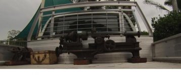

What I believe I have is a Willimott - Ideal Lathe from the 1920's era.I found it at a garage sale here in oz. The lathe came complete with original tooling with hss tool holders, boring bar, various drills, etc. All the lathe needed was a real good clean up and a small rebuild. The previous owner bought the lathe at an deceased estate sale were the owner was a machinist therefore well looked after. He bought it with the intention of rebuilding it but never did and was reluctant to sell it to me. being a young fitter and turner (millwright) apprentice about to finish his apprenticeship I bought it and gave him 500 bucks for it. here's how it came. Sorry for the poor pictures posting a thread about this was an afterthought.
P.S If anyone can help me identify the date of manufacturer or the company who made this thing please send me a pm

I confess, I was unfamiliar with gap bed lathes and wasn't sure if a po had carved out the bed like that or if it was factory. I like the t-slot on the apron. The overhang on the foot gives it an unusual appearance. It's an interesting project, kudos for taking it on!
Fretters
Jan 25, 2014
4,217
South Yorkshire, England
P.s Fretters these old lathes are a rare sight, Australian hercus lathes and Myford are quite common as wells as various "hafco" lathes
Whereabouts are you located, country wise? Might be handy adding that info to your profile so it displays in your posts.
The gap was quite common over here. It'd seem unusual to see an older lathe without one. It's only of any use when turning between centres or using the faceplate though. Once the chuck is on, the piece is usually beyond the gap.
Tee slots seem to be another thing we deviate quite a bit on too, as I found out a while ago. Seems that was something which never became common over there? Pretty much standard with smaller lathes to have at least a couple of slots, for example.
Typically, a removable section is positioned in the gap to provide continuous way surfaces. When a larger swing is required, the removable section is removed.
That's the setup we tended to have on the larger lathes, with the removable gap piece. The smaller lathes rarely had the gap piece though, just a permanently open gap.
This particular lathe came with no removable bed section, i don't think it ever did the gap has no "seat" or threaded holes where it could have possibly be mounted
