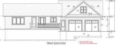

April 22nd, 2022 - 1st set of approved drawings:

June 23rd, 2022 - The new drawings were done, permit revision and drawings approved by the City, Here were the new drawings:
All in all, I wasn't too upset with the revised plans, much bigger garage, nicer use of space, so I was happy.

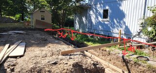

Sept 15th, 2022 - My buddy sent a guy today to do the backfill and grading, it became evident 2 hours into him being here that he would need help so I put on my boots and helped him. This meant no progress pictures, only after pics. He had already filled a bunch of the area with dirt when I asked him what he's basing his grade level on..he looked puzzled lol So I took out my measuring tape, the chalk line, laser, and we marked the foundation walls with the proper heights.
I'm doing 1% slope from back to front for water drainage (this is code, well, code really just says has to drain back to front and 1% seems to be the acceptable minimum, anyone do less than that???)
I'm factoring in 4" of concrete, 4" for Amvic Pex Insulated foam Panels and we did 4"+ of clear gravel
Probably missing about a ton of gravel so he's going to come back tomorrow to finish up. It's really nice now to be able to envision the space! (first thought, wish I had room for way bigger...lol)
The trucks have to navigate the neighbors hydro line and cable line above, it's tight!!

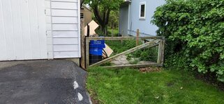

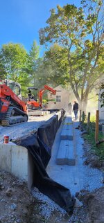

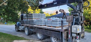

Sept 20th, 2022 - Not too much has happened, yesterday the guys came to start grading for the retaining wall along the side of the garage:
We decided to go the economical way and order some Concrete blocks at $150/Block (SOOO cheap compared to other options), they were supposed to be 2x2x5 smooth top only a recessed hook, they delivered 2x3x6 with keyed top and protruding hook.....needless to say that wasn't going to work.
So a wasted day today (it was a nice day at that) figuring out an alternative solution and I'm going with Siena Stone Wall from Unilock. They came and trucked these blocks away this afternoon.
Like this (this property is significantly nicer lol), my wall is only 3 courses then the coping so not super tall at all:
Hopefully all the rain they are calling for tomorrow doesn't come because they are supposed to finish this week and the framing next week!!

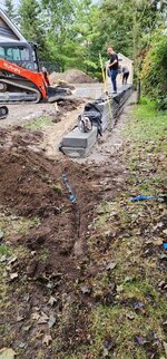

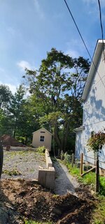

Sept 21st, 2022 - Today the tree guys came to cut a few limbs off this tree back here as they were overhanging on top of the new garage. They made quick work of it!
I used the skid steer to help get some of the logs out!
This is much better!!
Then I had to pull out of the ground and re-run the Phone and new Fiber Optic lines that the local Telecom company ran. It was easy to pull up since it was only 1/2in burried :rolleyes: But they ran mine and my neighbors basically right along my driveway so I moved them over to the property line as we will be bringing the wall further forward and didn't want to cut them.
I marked the new location with paint.

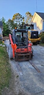

It sure is nice to have machinery like a Skid steer during construction! What's the story with the loader in the picture?
Your storey about the conduit has me a little worried I have 220ft one inch conduit for internet/cable. Hope the telecom company can get the wire through it all, my electrican thst put it in said 'no problem the telecom' but I wonder....
J
JeromeM
May 28, 2022
33
The loader was for those huge concrete blocks! They were supposed to be 2x2x5 so the skid steer would have been able to unload them. Well at 2x3x6 there was no way so they needed to go get the huge loader from their shop to come unload from the flatbed. Then loaded it up the next day.
Here the telecom companies (Bell) just run the Fiber Optic lines just barely buried in the ground, no conduit at all.

Sept 23rd, 2022 - New Retaining Wall blocks showed up at 730am, guys weren't here yet but the Skid Steer keys were so I dropped the bucket, hooked up the forks and helped unload and stack the skids on the driveway, so much fun lol 😁
Then the guys showed up and started final leveling and laying blocks, I went to do some running around while they did some of the first blocks.
They finished the day with the rest of the 3rd course along the garage and they ran the 4" Weeper along there and backfilled it with Gravel (Will insert a pic here, not sure where my picture I took went).
They will be back on Monday to finish the final row and then do the section along the driveway, it looks AMAZING! I wish I could have this be further out but due to setbacks etc. this was the best I could do. It's not going to be a high traffic area, will remove the fence after and grade in there and will look a lot nicer.

Sept 26th, 2022 - Today the guys came early to start on finishing the retaining wall. They did great work today, I mis-calculated when I ordered the stone I didn't realize we needed to step up at the end of the wall to give it a nicer more gradual finish so I was missing 2 x closed end coping pieces and of course they are now out of stock so just waiting on those for it to be finished finished.
Tomorrow they are coming just to wrap things up with the weeping tile and backfill. I'm going to do some interlock along the side of the garage, not sure what yet as there's not a lot of room so I'm hoping to find something that I won't need to cut every single stone. I should have a ~3ft walkway along the side. This also enables me to widen my driveway with a nice finish. Before my driveway had crumbling asphalt sloping on the side, gross.
Pics of today's work:
Finished wall minus the 2 closed end coping pieces one on the 3rd and one on the 4th row creating that step up to help transition, you can see that front coping piece (second from the bottom, that bottom one will be burried once final grading is done) has a closed end so you don't see the "key". Will look sharp one done.
Material for the walls showed up! WOOHOO!!
Framing might start this week apparently, framer is really good but not the best at keeping to a schedule. Once he's onsite though, works really fast. (He framed my buddies super complicated 2nd floor addition done all within the existing roof structure. was a lot of work.

Sept 26th, 2022 - Retaining wall finished today (still missing 2 Coping pieces at the end and I need to put some interlock between the foundation and the retaining wall).
I haven't seen the framer yet...he didn't seem to be too worried about getting the walls framed before the trusses show up on Oct 13/14 so let's hope or else I will do the walls by myself!!!
