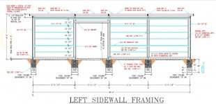

I have begun clearing the area for the new garage. I did make some changes to the plans once I realized that 13 ft eave height would not give me the correct height for a lift, so it has been changed to 14 ft eave height. Here are some shots of the plans.

Shouldn't the posts on the side of the man door go as deep as the other posts to get below the frost line??

I am purchasing a kit from Hansen Buildings with MA engineered and stamped plans. I thought the same thing about the posts for the entry door but I guess the engineer feels this will suffice. Once I have the plans in hand(tomorrow according to FedEx) I will be submitting them to the local building department for my permit. If there is a problem the building inspector will let me knw, I have a good working relationship with the building inspector and his department which helps when I have questions about grey areas. Thanks for all the input, exciting time and hoping that I have covered all bases.

The 14 foot dimension is measured from the existing grade, not the top of the finished floor....is that an issue? In other words its not 14' of interior clearance.

Eave height is measured from the bottom of the skirt board to the height where the roof steel intersects with the side wall steel, that's why I wound up changing it to 14 feet so I will have the required 12'5" interior height for the lift.
