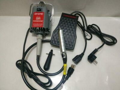

I know this about attachments but get one of these or a knock off , far better then an under powered, over heating Dremel (had 3 Dremels).....
