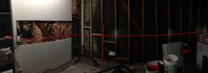

Hello all,
I figured I'd start a thread documenting the (re)build of the garage attached to my first home. Some of you may have seen these pictures before in other threads, but I'm trying to get them all into 1 thread.
Here is what I am trying to accomplish:
1) Plumbing for sink in the inside-left corner (sink will mount in workbench).
2) Electrical for the back (bare) wall.
3) Insulate the back wall & ceiling, then hang drywall.
4) Paint the walls.
5) Build workbench & hang cabinets along the back wall.
6) Build shelving/storage along left and right walls.
7) Finish the floor (Epoxy or RaceDeck, still evaluating my options).
I've already completed item #1 and am working on item #2.

Does anyone know what it means when pink insulation turns black, like in picture #4 I posted? Could it be mold?

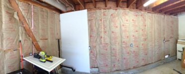

Sorry for the late update, but I've got quite a bit work done.
I've torn out the moldy insulation and took out an 8ft x 8ft section of the wall to check for more mold. I figured better safe than sorry. Bleached the area, completed the electrical in the wall, insulated and hung 5/8" fire code drywall. Still have to clean up the wiring in the ceiling before I insulate and drywall that. I've gotta rent a drywall jack too because it was painful enough doing the walls with my hands. :lol_hitti
Any advice on dealing with the garage door opener and track brackets? Take them down completely or just unbolt one at a time while sliding the new drywall in?

IMHO it would be a pain in the **** if you left them there whilst you were trying to fit the dry wall, that said depending where your sheets end up in relation to the brackets it would not be impossible to work around them. Do you have anyone to lend a hand?

I was going to attempt to use a drywall jack to help me get the peices in place and simply unbolt 1 bracket at a time while sliding the drywall between it and the joists. While it sounds good in theory, I would imagine it wouldn't work out that well in practice.
How difficult is it to re-install a garage door if everything is taken down during the drywalling?
