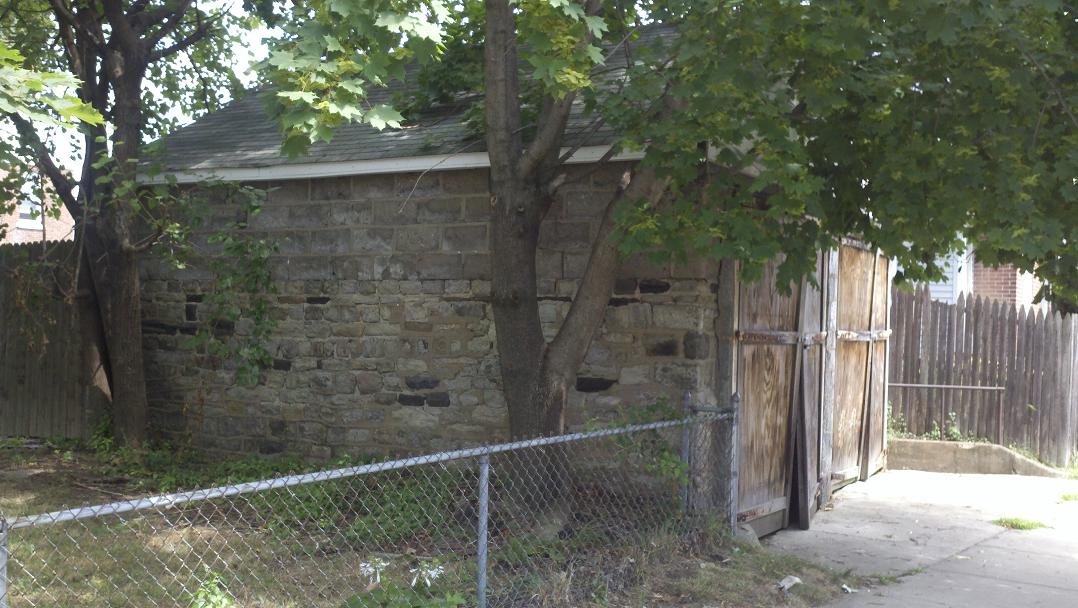

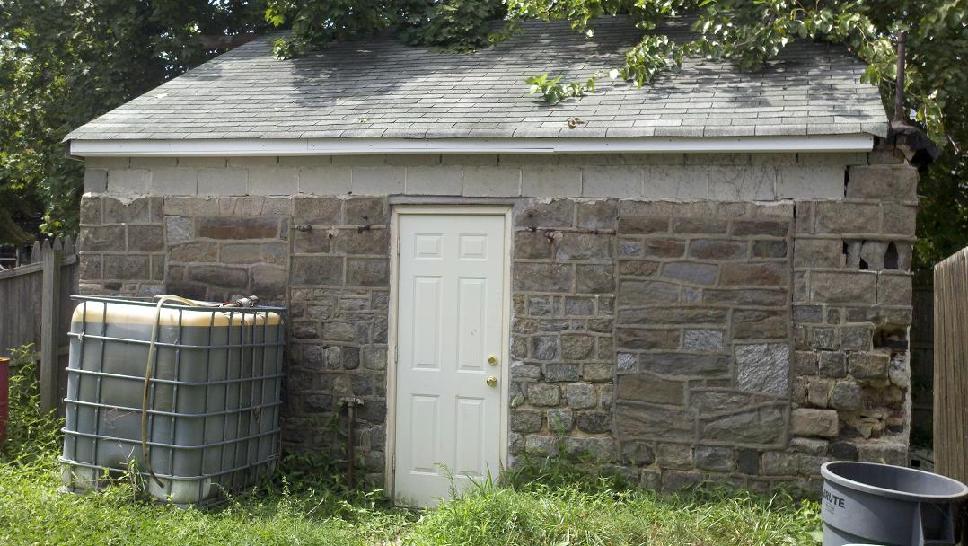

I tell people I have a stone garage and usually get the same response . . . 'you mean brick?'
No. I mean stone.

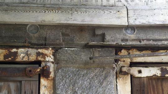

Would like to see original pictures of this.

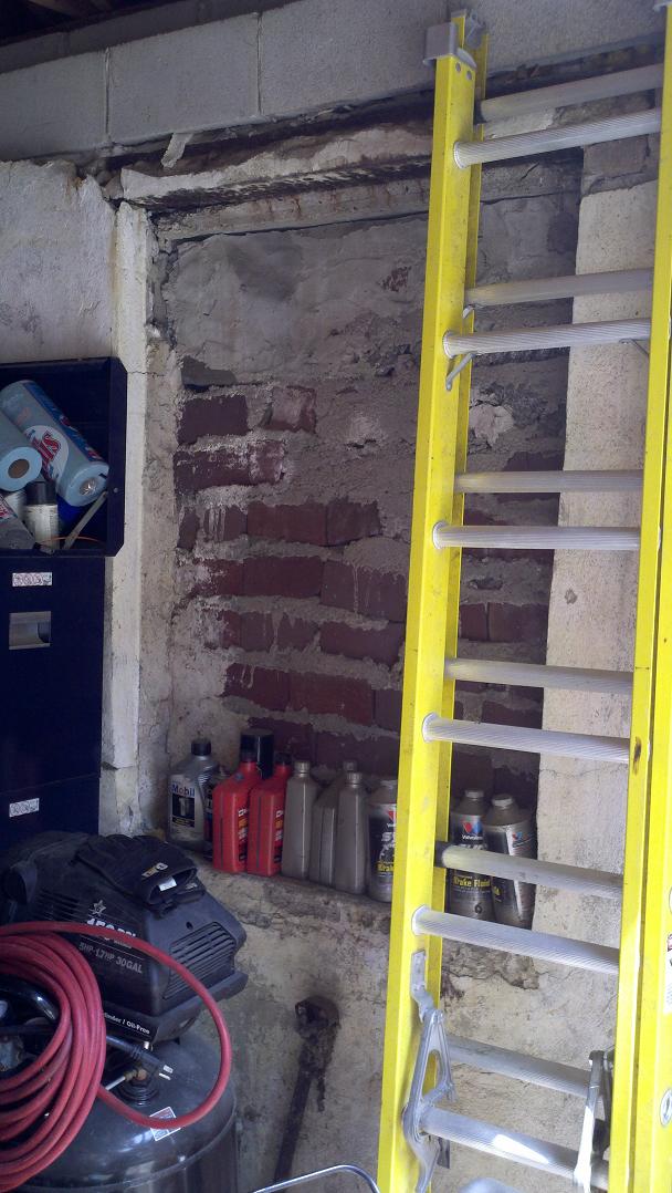

Kind of wish I still had the windows installed. Can't imagine what it would cost to put some back in after cutting out the brick/stone that replaced them.

Wall separates the two bays, I'd like to get rid of it, but it is structural, so I'd have to have someone come in and but in a wood or steel beam in its place, I am extremely interested in doing that, but the garage needs some upkeep and the wall isn't really that high on the priority list.

Wow, this could be a REALLY neat old garage if you restored the original door hardware and built some new carriage doors. All the help you'd need is here on this site if you search and decide to take it on.
Windows: If those headers are still sound there's no reason you can't chisel out the brick. Just make certain the beams are solid. Just make sure you replace the windows with era-correct wood windows. Take some measurements and start searching for a local building wrecking company. They sell the old stuff out of structures.
Wall: Yes, taking out the entire wall would be costly BUT, you could sawcut out a pedestrian door, even a bit larger (maybe 4-6 ft) with no issue. You'd have to replace the portion removed with a structural frame but that isn't as difficult as it sounds. I recently removed most of the back wall from my 1930 garage (no, not a stone or masonry structure) and mine was WAAY more work than this would be. I'd take it on.
In short, you sawcut out the stone and shore (if necessary) with wood. Install a structural channel as close to the width of the existing wall as possible and that mounts to the stone via drilled and epoxied bolts into the stone. Home Depot/Lowes sells the epoxy you'd need. If you have more interest in the idea, drop me a PM and I can explain better.

As far as opening up the garage, the wall is just 2x4 studs with plywood on one side. While I could remove the sheathing and maybe one stud for ease of movement, removing the wall and putting in a header/beam would require far more phyiscal ability and engineering skill than I have. I'd need to have someone come in and engineer a beam/connection scheme since it isn't all that cut and dry with regards to where the header lands at both ends.
I would love a steel beam, but wood may be what I end up having installed. I just want to avoid a column.
