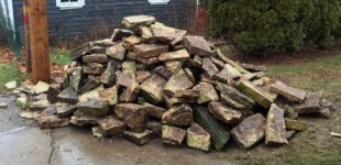

Now for the second score, since the house is all stacked lannon stone, this coming summer I'd like to add a few short retaining walls/planters. One running the length of the house in the front, one around the back patio, and finally across the backyard where there is a slight hill up to the garage. I've been keeping an eye out for stone on CL and was unfortunately getting beat out on a lot of it. My luck changed though and I found a guy 10 minutes away who wanted to take down a large wall along the side of his house. Three trips and a couple hours later I had this sizeable pile next to my driveway. I wasn't able to stack it at the time because I was trying to beat the rain we got that day, barely did as it was.
The next day was a little nicer, so I stacked it in a halfway descent pile and got it back in a corner. It's not pretty but it's a little more out of site for the neighbors and doesn't look like as much of an eye sore. I'll split the larger pieces over the course of the winter/early spring in preparation for when I build the walls in late spring/early summer.

Finally got to the fun part, with the lannon stone, for this I mixed my mud by hand in my wheelbarrow, I could've done it in the mixer, paddle mixer would've worked better, but it's also a fuss to keep it clean. With the down time between bags, it just worked out better to mix by hand.
Started on the inside for practice, worked up to the corner, then around and up. Skipped the end by the sidewalk because dumb-dumb here didn't bump the sidewalk out far enough away. Then worked my way around the front. My solution for the sidewalk end was to put a piece of 1" aluminum angle iron on the bottom to act as a shelf. Drilled four holes in it and then used nail-ins to anchor it to the wall. On this side I also cut stone into more of a veneer size pieces, so that they wouldn't stick out into the sidewalk.
