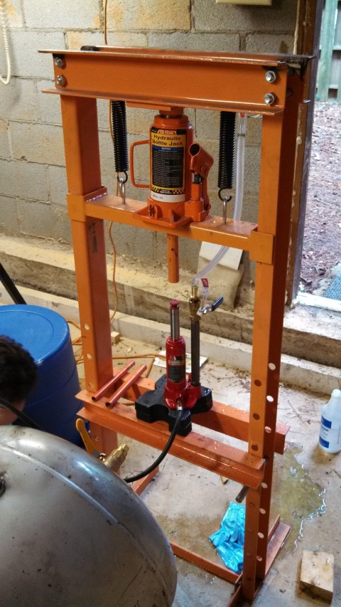

I have an old horizontal 80gal tank that was an IR T30 compressor, mid 80's vintage. I figured I was going to build a new compressor around it and should test the tank before proceeding.
For my test I left it horizontal, but lifted one end with a stacked pair of 4x4 scraps so that the 3/4" NPT hole from the check valve was the highest point. I filled the tank with a hose until this was full.
First attempt to pressurize was done using a cheapo grease gun (typical task-force type deal) which would not seal the plunger to the gun to even hold water. Second attempt was with a nicer grease gun which kind of worked with water vertically but didn't really work that great.
So I changed direction and built a pump out of a cheap 2 ton bottle jack I bought at Northern Tool for $13.
I used a 3/4" NPT to 1/2" NPT bushing, a 1/2" NPT to 1/4" NPT bushing, and then a 1/4" NPT check valve from McMaster to fill the hole from the original tank check valve.
From this I used two 18" grease gun hoses (Northern Tool) which happen to have male 1/4" NPT ends, and a 1/4" NPT coupler.
The bottle jack was modified thusly:
The screw to release the piston was removed, and a small 1/4" NPT ****** and coupler were used to attach it to the grease gun hose. The pump handle and pump fitting were removed, and replaced with an 8" 1/2" NPT ****** and 1/2" NPT ball valve. Then from the top of the valve I used a barb fitting and some tube which I kept topped off on water. I then placed the bottle jack in my shop press, and used this new 1/2" valve to fill the jack with water.
Basically I did the following:
Fill tubing with water
Close hand valve on bottle jack
Extend (pull) piston out all the way
Open hand valve on bottle jack - water level drops as jack is filled with water.
Close hand valve on bottle jack - allow to pressurize water out of old screw hole
Push piston back into jack.
Rinse and repeat

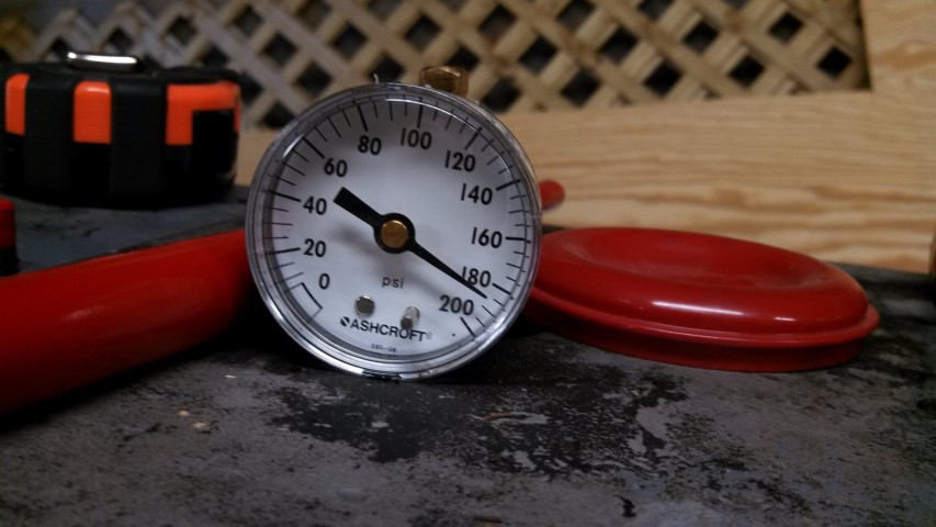

I was able to pump the tank up to about 70 PSI with water just by hand operating the piston in the bottle jack. Past that I started having to use the shop press to compress the piston. I took it up to about 190 PSI.

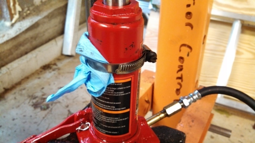

At about 180 PSI the vent/relief on the bottle jack popped, and I had to close the hole up with an improvisation:
Overall this worked really well.

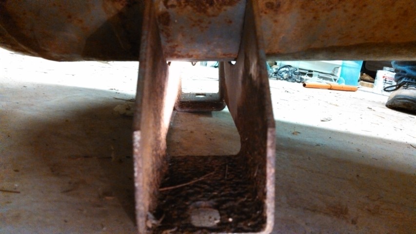

Unfortunantley, the tank failed the hydro test. A small dripping leak appeared at the bottom of the tank between a leg. This did not appear until about 180 PSI. The tank was ASME rated and had a tag stating it was 200 PSI working pressure.

Good job, but look at the trail from where the drip came from. From the picture, it looks like the underside of the tank is wet from much higher to the right and the water ran down to the drop you see hanging. I wonder if the tank was leaking or that came from a hose connection on the other end. :dunno:
Either way, glad you showed us a good way to test tanks, hope your tank works out for you!

Obviously this was done with a cheapo chinese bottle jack. I wouldn't recommend using one that you like. And yes of course this was a simple leakdown test, nothing more. However as I saw this was able to detect an issue.
Unfortunately the leak was an actual leak and not something that was running down the tank. I wiped the tank down good and was able to observe the droplets building there from the tank, and definitely not some residual water.
Had the tank not started leaking I was planning on conducting a test to 200 PSI and then a second test to higher pressure. All I had on hand at the time was that 200 PSI gauge to start with, but with the leak it was bunk.
