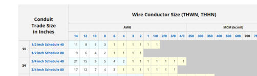

10 ga will easily run through 3/4 PVC.. Fill table says you can get all of those wires in there if you want to do it that way:
