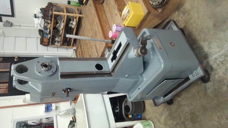

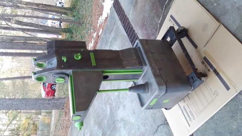

I've been busy cleaning, stripping, and painting the mill after basic disassembly.
After a gallon of Simple Green and a few passes of CitriStrip I was able to mask and paint the parts on an opportunistic warm day.
I was lucky enough to snag a full set of X and Y leadscrews and nut from someone converting to CNC ballscrews, which will solve my bent and cut off X axis screw.
I also have located a Bridgeport M Head with a round column adapter for a reasonable sum which is underway. I also procured a generic X axis power feed which I will mount on reassembly.
While everything is apart I am replacing bearings in the motor and leadscrew handles.

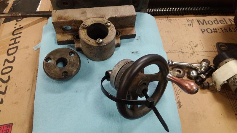

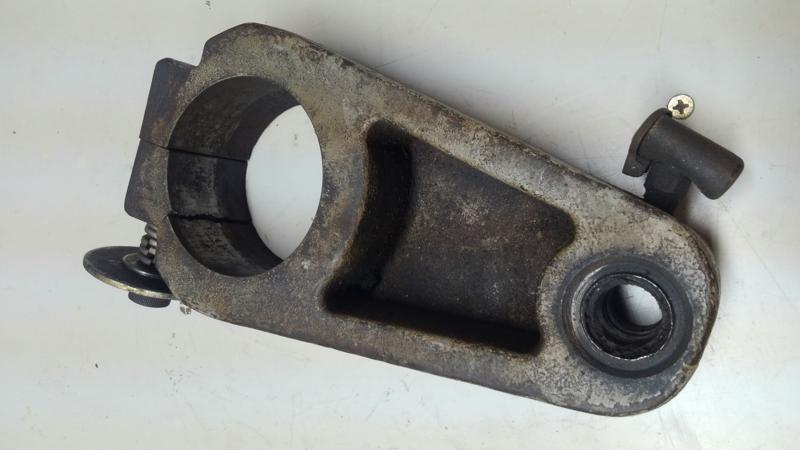

1. Missing all of the right hand x-axis parts still. Handle, graduated dial, and bearing holder/cast support. Photo of left hand mostly identical parts for reference:

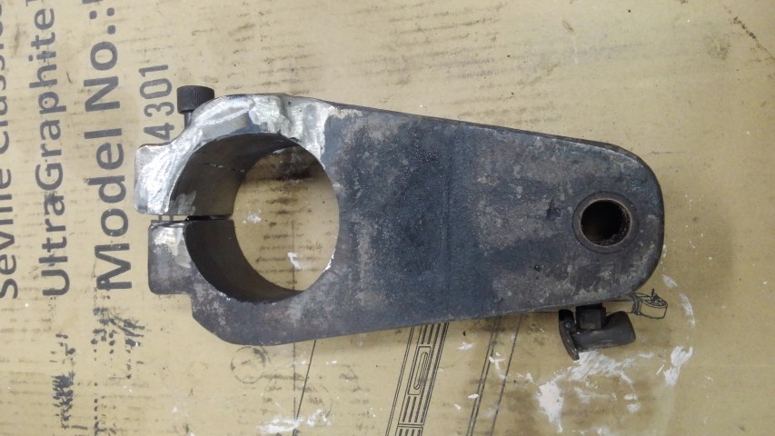

2. After closer inspection I found that the overarm support is cracked. Not sure that this can be repaired due to the location and stress on the area when clamped:
Working also on prepping the final location in the basement and figuring out logistics to move it.

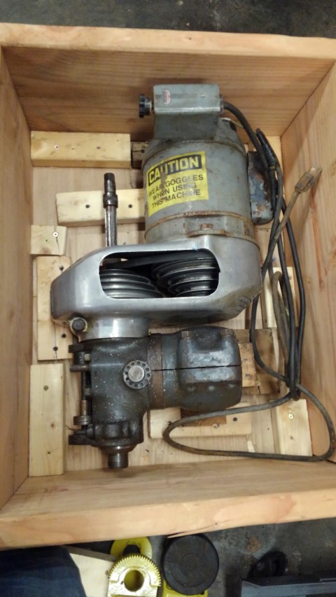

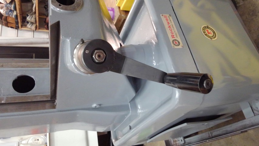

More parts and progress for the Rockwell horizontal milling machine. Bought an M series Bridgeport head with round column adapter to fit onto the horizontal mill. This will give me options to do either horizontal or vertical milling. Found a replacement knee crank handle, and got the cracked cast iron overarm support welded and reinforced. New bearings for the horizontal motor and the crank handles have arrived, as well as new start capacitor.
M head will be checked out, cleaned and painted. Will need to make a reducing bushing from the 3.5" of the round column adapter to the 3-1/8" overarm on the mill. The M head has a 1/2HP single phase motor. I have a few VFDs and would love to find a 3 phase motor so I can do variable speed. Otherwise for now the single phase motor will be checked out, new bearings if needed, etc.

If you can obtain a 3 phase motor with a NEMA C face, you can make a two ear mounting plate to convert the C face to mount on the M head. The C face motors are often used on conveyor gear boxes, as they will bolt straight to the gear box.
