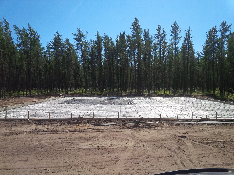

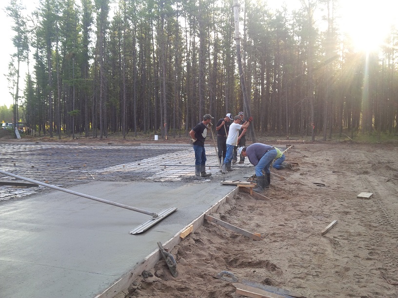

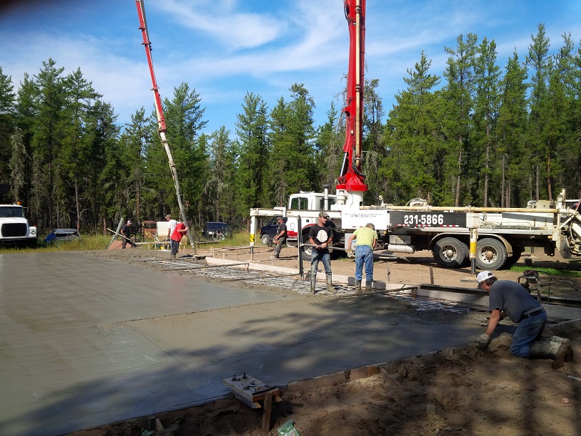

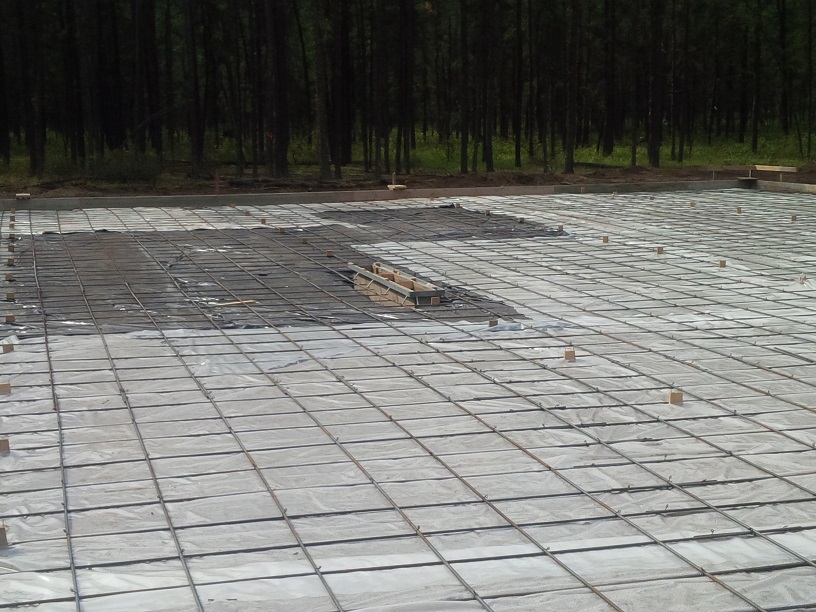

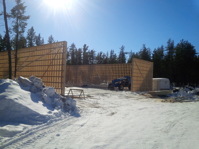

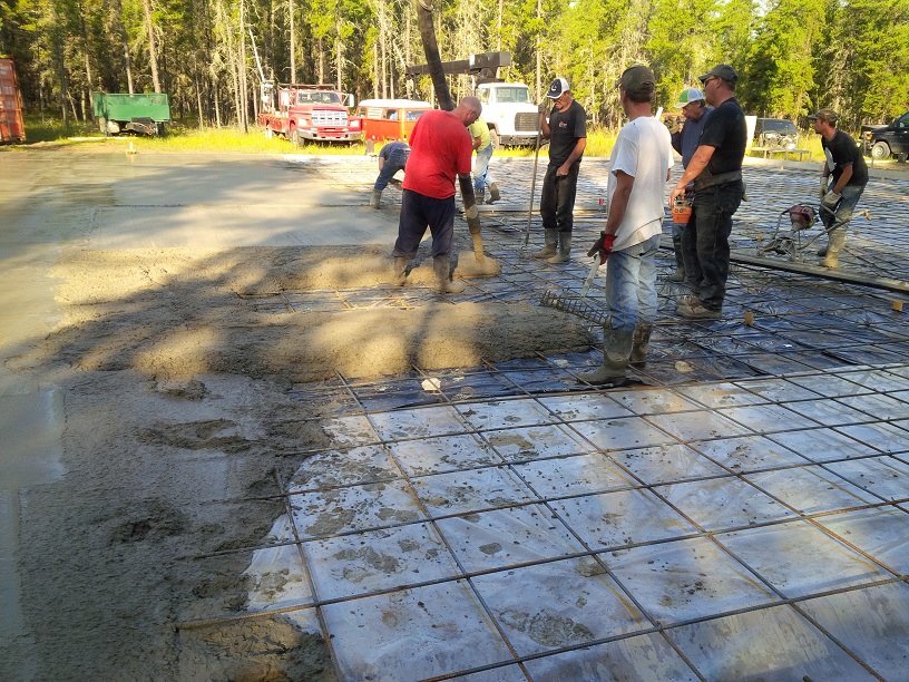

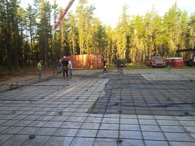

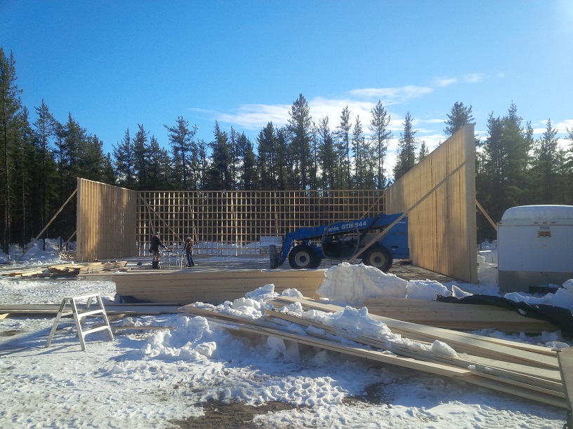

Hi all, Well after many years of going back and fourth about size, shape, location, color, details, I have finally pulled the trigger and started my shop build. The contractors did the pad last fall. 5.5" of 4500PSI concrete, all sloped to the center drain. It was originally going to be a steel frame shop and that switched shortly after the concrete was pored. It is 70' x 80' x 18'. 2x10 stud frame. It was a $2500 upgrade to go from 2x6 so I opted for it , as well as about $2500 to go from 16' walls to 18 so again, I thought it was worth it.

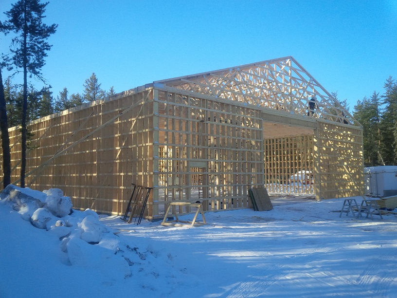

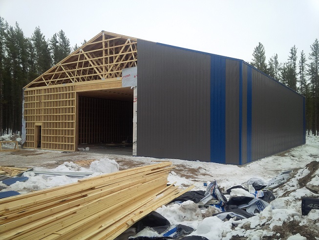

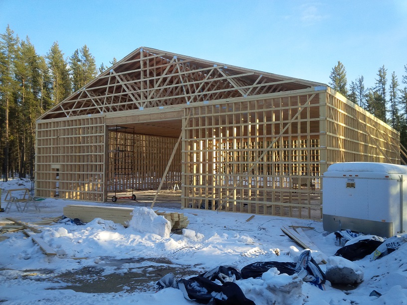

Well like I said, it started off steel, then switched to wood. It was about $2400 to go from 2x4 to 2x6 then $2500 again to go up to 2x10. It was one of those things that in 10 years I didn't want to wish I had spent $5000 more to go thicker and taller. This is going to be part welding/manufacturing and part to feed my car addiction. I have a 2 post Ben Pearson car hoist to install, and there will always be at least one car in the shop at various stages of restoration. The welding side will hopefully bring in what is being spent on the other side. :)

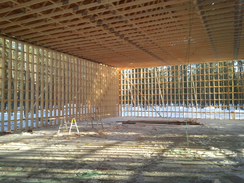

I am now trying to decide where to run the water (hot and cold) and air lines. Would I be safe running them inside the walls? I plan on boarding the walls with tin over. I like having a clean look of no pipes running around the perimeter. But was I bit nervous about running water lines inside walls for the fear of freezing.

2x10 walls!! That is going to be awesome. What r value are you expecting and what type of insulation will be in the walls? Having water lines in exterior walls makes me nervous, but with 2x10 walls I might do it. Thinking out of the box here.... If you would box off an area around the lines behind the interior steel and then put a couple register covers in the area to let some heat to get around the water lines. This boxed area could be sealed and insulated real well also. Hopefully you understand what I'm saying, it's crystal clear in my head. Haha

I think I just have to decide on where I actually need water and just run on the outside. I was thinking the same thing, that 10 walls would give enough insulation value but there again, it is receiving no heat from the shop at all, unless like Sims mentioned about ducting in some heat. Not sure on the R value yet, have to talk to my building supplier and see what he recommends. The tin will be done likely next week. I already have some mods for the boys to do, a few windows, a smaller roll up door in the back. Seems every time I look at it I come up with a new idea... Guess I should quit looking!

I doubt you would have to actually duct in heat just have some openings in the boxed in area where the water lines would be. Biggest thing is to seal any drafts from the outside air. If you let some inside air get to the area I'd think you'd be ok. Some people have water lines in exterior 6" walls with sealed off walls.

From your location, my guess is that it would get pretty cold in the winter. If you're really worried about plumbing freeze ups, why not wrap all the supply plumbing in the walls with electrical heat wrap, and have it set on a thermostat to go on below a certain temperature. I'd also wrap any drain traps that are inside the walls, as they will hold standing water as well. If the building keeps the pipes warm enough, it will never turn on. But if you have an extended cold spell, you're safe. You really don't want to every have to rip open a wall for a plumbing freeze up.

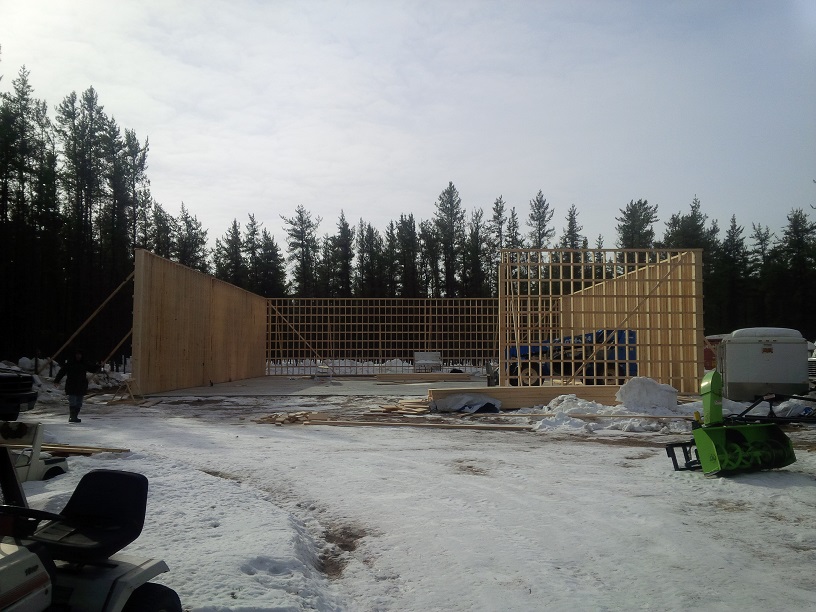

Sims, the trusses are 24 OC and walls are 16 OC. Good point Skyline. The building is going to be finished tinning on the outside this week then I will plan the power, air and water.
Laramie, I just went 2x10 for overall strength with the 18' walls. Overkill I know but I never wanted to regret anything, although I have a short list already:) I am not sure which is better for thermal.

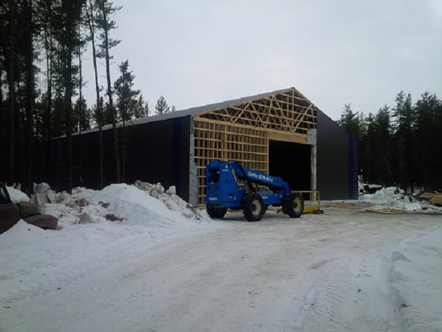

Ill have 4 windows in the roll up door in front, 3 in the 10'x 8' going in back. Just trying to keep it as secure as possible. I may decide before tinning inside to put a few more in but would keep them up higher.

Actually i put the interior on hold until now. My contractor is framing in my bath, utility, office, tool room and mezzanine in January. Then wiring, tinning etc. i will post as soon as there is some action. Thanks!
