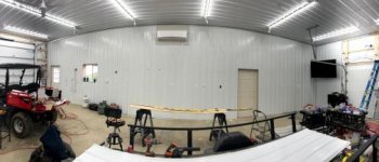

I debated between drywall, plywood or steel for the walls. I wanted to be able to get into the walls in the future if needed since there would be water, air and electric in the walls so I ruled out drywall. I didn't really like the look of plywood but it was cheaper than steel. Well, as the price of plywood went up, steel actually was cheaper. I am very happy with the decision. I love the look of the steel walls and ceiling.
Had to move from the side wall to the back wall to get the all important 70" TV mounted.
Laser level to align screws.
Air lines coming out of the walls with an escutcheon plate to make it look clean.

Office is done! Looking forward to working out here and not in the basement anymore.
Looking great! I can relate to the pleasure in getting your office above ground, as mine was also in a basement for far too long.
