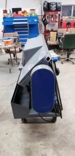

So with everything down to bare metal it was time to start putting lipstick on the pig. I decided that rustoleum smoke grey would be the primary color for it as I just didnt care for the original goldish green it had been and thought it would look better if I painted the controls and moving parts a different color so I went with a shade of blue similar to my work bench and cabinets in my shop.

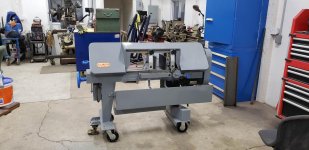

I added channels and casters to the base so I can move the saw as needed because with it weighing in at around 900lbs I would have had to use my tractor to move it and I really didnt want it setting out in the middle of my shop either.
Finally got it back together enough to test run a couple weeks ago and actually used it a fair amount for a project for a freind of mine. Also picked up a nice roller stand that I painted to match the saw.
So last night I finally got the hood and coolant tank/chip pan back mounted up. and the old girl is running as good as a new one!
Notice the floor lock I had to add to keep it in place once on casters as it was walking itself around the shop when running without it.
As far as parts go I ended up replacing both wheels since I dont have a lathe big enough to fix the bore in the drive wheel or the shoulder that was worn off the idler, output shaft on the gearbox and necessary seals to change it, Rod seal on the feed cylinder, bearings in idler wheel, and all the guide bearings for the blade.
So at the end of the day I think I am into this saw for $800 or so and quite a bit of time. LOL

Well done, that will cut a lot of steel!! Where did you get the foot lock at? I want to do the same thing on mine

Thanks, got lucky on finding cabinets all the same color for sale. For what its worth Rustoleum sail blue is a really close match to it so that is what the handles and small peices on the saw are as well as my work bench in my shop.
