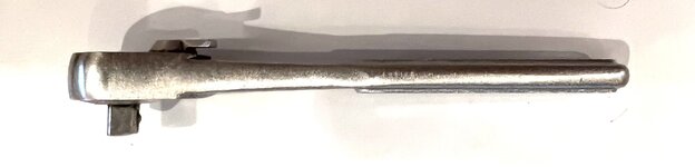

Its not 1/4" its 9/32 drive, which was something they tried mostly around WW11 thinking it would keep guys from taking tools home from work.
The ratchet attachment on it is not readable as to manufacturer. But it does read Pat Applied For, Southgate California

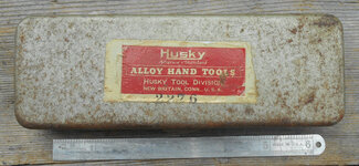

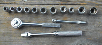

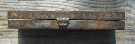

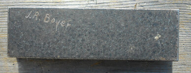

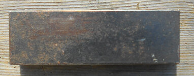

I found this scattered about a hoarders garage:
Some parts were in the original socket box, some parts were in a junked socket box in another part of the garage. The wrenches came out of my stash. Serendipity.
Husky 2276 11-piece 1/4" drive SAE socket set w/ original box
Manufactured by New Britain Machine Co., New Britain, Connecticut
the set contains:
H3600 1/4" 6-point
H3601 9/32" 6-point
H3602 5/16" 6-point
H3603 11/32" 6-point
H3604 3/8" 6-point
H3605 7/16" 6-point
H3606 1/4" 8-point
H3607 5/16" 8-point
H3608 3/8" 8-point
H4598 6-inch flex handle (breaker bar)
- 3/16" x 3-inch cross-bar (tommy bar)
(* the box changes color depending upon what kind of light is on it *)

MisterEd
Oct 3, 2019
746
Florida
Acquired these today. Anyone know anything about the push-button model?
