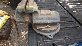

Found this stuck to a workbench on the local craigslist. I realize that it is broken, but am more curious about who made it. Is this something any of you can identify?

Yup - made in Poland. I bought one over 40 years ago - very nice vise. You can adjust the gibs to take up any slop. Even with it being broken it might be useful - and certainly better than no vise at all!

These aren't uncommon in eastern Europe. I seem to recall they often cracked like that.
This Polish style is inverted when compared to the German style dovetail vises (leinen, schlegel, gressel...). On those, the rear jaw would go inside the base instead of hugging it. This Polish style may make the guides and the lead screw less exposed, and also made to incorporate a swivel underneath while the classic German design fixed to the end of a table. But most likely the polish cast iron wasn't very high quality so a lot of them cracked like that.

Bison vises are similar (The US branch of FPU?). For a few $$, that one should be fine for most uses.
I have a 5" version, not sure if its a real FPU, Bison, or knockoff

that's an FPU vise. I'm pretty sure they are made in Poland. I'm sure the experts here can give you more information than I have. If it was cheap enough i'd buy it for sure!
The whole shebang is apparently $75. When I posted this thread earlier, the price was $99. Not my ad, by the way.

It reminded me of a Gressel I saw some in an old youtube restoration video. It's an interesting format. Not sure how useful it is for larger workpieces to make the outboard jaw static, but I've been keen on taking that design for a spin.
That’s a genuine FPU, made in Poland. Look at the emblem. That’s the mark of the real deal. They are great vises. Even with the cracked off piece, it could still be useful.

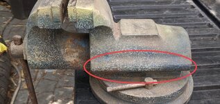

I have one of these. Its a 6" jaw version that used to be my fathers. I remember from being a kid he had it mounted on his work bench in the garage. After he passed I found it lying in the corner of his basement on the floor. I thru it in my truck and brought it home and found out why it was in the corner. Its missing the gib.
Now I;m trying to track down an OEM piece. I can always make one as I have access to a tools shop but I want an OEM part. Anybody got one? It should be about 9 1/2" long with three recesses spaced 3 3/8" apart on the one side. It will be about 5/16 thick and have a short side profile like a parallelogram.

You'll never find an oem gib.
I wouldn't say never. I've found two people that have the vise but both of them are cracked along the dovetail so I;m hoping they would consider parting them out. They both have the gib I need so I'm still hoping.
