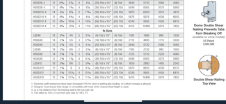

Good afternoon,
I’m trying to sink 16d hdg nails through a couple of LVL rafters to hang a big Simpson hanger. Using both a hammer and a palm nailer, I’m bending about 50%. Where I can, I predrill per the Simpson guidance (I forget the bit size right now) and it works fine. Though the pic doesn’t show it, some holes are too close to the perpendicular LVL to drill. And the angle makes the palm nailer useless.
The OCD part of me really wants to fill up all the holes.
The only idea I can think of is to lube up the nails with wax. Or switch to shiny sinkers (ugh). Or I could try the stubby nails if that’s all that will work.
Really just venting. I’ve spent way too much time up there working on this and I’ve got two more to go.,

Dry fit to mark the lead hole locations. Then move aside and start lead holes with small sharp nail, then drill.

Simpson allows the use of 'Strong Drive' screws in lieu of nails. There's some adjustment to the load tables. There's is another fastener substitution schedule buried somewhere in their literature. I just went through this.
Scroll down to bottom of linked page
Edit: 2nd Fastener Schedule
I’ll try some genuine Simpson nails.
believe soap promotes corrosion. But toilet ring wax is ok.
Thanks for the research Rusty. For some reason. I thought I read that only nails can be used. Can’t find out now. But found this. Seems odd but there it is.

Just get a metal rod that fits into the socket of your palm nailer. Place the rod between the nail and your palm nailer. Problem solved.
I built a triangular deck and this worked great in the tight corners.

You're supposed to use Simpson nails.
Nothing special about Simpson nails although it's convenient to use them if they are more available, especially for some sizes.
As for filling all the holes you need to refer to the specific hanger data. Simpson shows allowable loading for several nail options for most. Sinkers are smaller and reduce load capacity. For this hanger it states to fill every hole. It's for a good sized beam so I wouldn't want to be cutting corners.
I would figure out how to drill them. Can you mark and move things out of the way to drill? Or get a long drill bit. 90 degree drill or drill attachment may help in close quarters.
