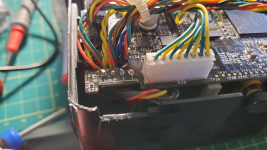

I purchased a 3 pack of the ESP32-C3 Mini boards (** must have 4MB of memory) from Amazon for $20 CAD, followed the directions (Note, the pinout for the C3 Mini boards for the TX and RX is GPIO3 and 4 of the board,... not GPIO11 and 12), flashed the OpenNeato firmware and PRESTO! - full control over the vacuum again!
Once the Neato is open,.. find the 4 pin diagnostic port on the left side. I de-soldered the port so that I could directly solder my wires to each thru-hole:
Here's the ESP32-C3 mini board with Ground, 3.3 volts, TX (Black), and RX (White) connected.
Testing with the unit open to ensure remote connectivity:
Hot-glued in place:
And the app that's running directly on the ESP-32 unit, remotely accessible from within my network from any web-browser:
