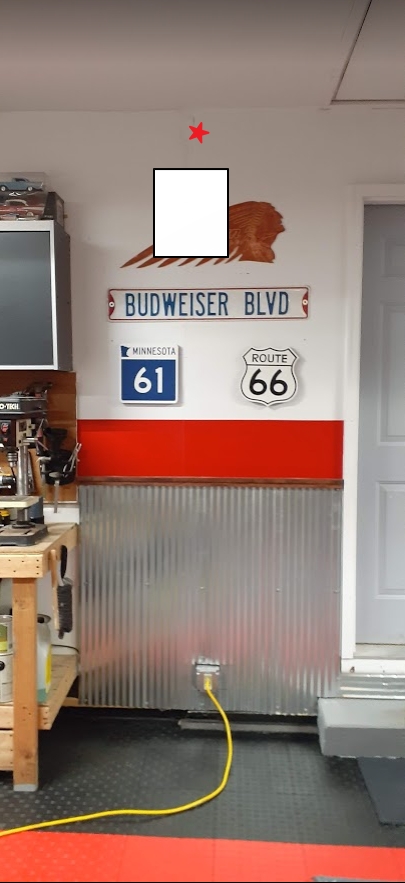

I now have a new service panel and need to put a 240v outlet into my garage.
The main panel is in my basement and the run of the line would be about 20-25ish feet from my panel in the basement and then into the garage coming up through the bottom of the wall into the drywall.
I am looking to run a Cadet Hot One heater which is rated at 5000 Watts on High and 3333 on low - Amps at 240v 20.8 / 13.9 amps.
I am wondering what size breaker I'd need and what type of wire to run this?
It requires a NEMA #6-30R receptacle
I am in MN so I am not sure what the code is here.
Prior electrician was hired to do this but never came back to do it.

Sorry I should have posted it - here is the new panel
So I have the correct 240v outlet for the heater, metal receptacle box, 10/2 with ground Romex, romex clamp connectors, correct 30amp breaker.
I know I am over-reaching here but if I run the line from the panel into the inside garage wall and run the romex inside behind the drywall my understanding that is code but I cannot secure the line other than with the romex staples as it leaves the basement into the inside garage wall and then the receptacle box itself with a romex clamp.
The 10/2 with ground wire has three wires (black, white, copper ground).... so I understand those three go into the NEMA #6-30R but do I have to also ground the outlet receptacle box, i.e. pig tail the ground to box and outlet?
Also can an outlet but at any height?
The Cadet heater will be about 16" down from the ceiling
Here is the garage wall... the white box is where the heater would hang and the RED STAR is where I am thinking of placing the outlet. Not sure if that would be acceptable or not.
