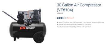

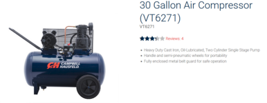

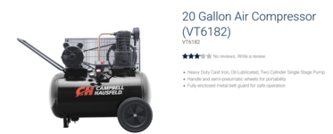

Many people still make compressors in this configuration [33 gallon, 5 HP, 10 SCFM @ 90 PSI, hot dog layout] including Craftsman.
I'm dealing with a limited space vertically for my compressor, and like the previous two posts, I go more for air delivery than tank size. If I had to replace my similar-spec Craftsman model, it would likely be one of these Campbell-Hausfeld models, as these are all I'm aware of that have these kind of air delivery specs for a 20-30 gallon hot dog layout, and are oil lubricated. I think all three are actually the same motor and pump:
VT6182, 10.2 SCFM @ 90 PSI, 20 gallons
VT6104, 10.2 SCFM @ 90 PSI, 30 gallons
VT6271, 10.2 SCFM @ 90 PSI, 30 gallons
UPDATE: Looks like Speedaire has models sold by Grainger that are exactly the same; I would guess that CH is building them for Grainger.
