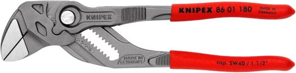

I have and like 6” Bahco. The newer Milwaukee models actually seem to be really highly regarded. I prefer pliers wrenches (Knipex) for most situations where I would’ve previously used a traditional adjustable but sometimes I still feel ad adjustable is preferable particularly as a backer.
