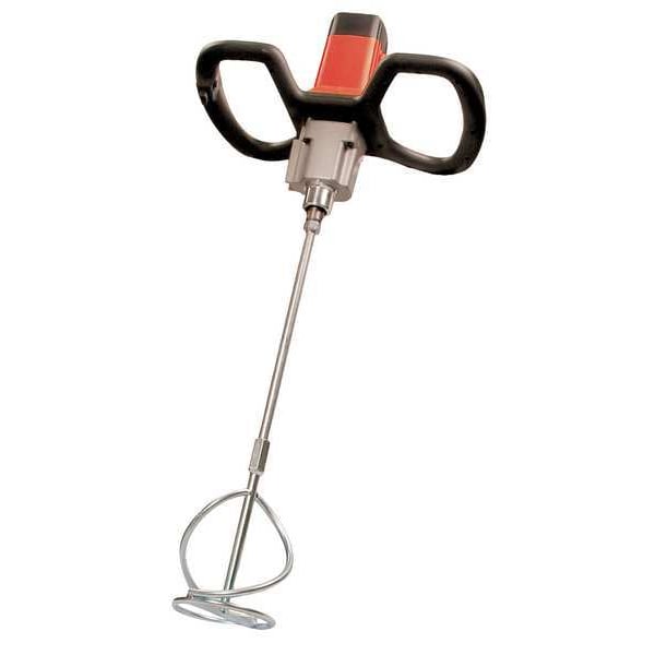

dont buy a drill buy a proper paddle mixer thats what i did to mix plaster with and i have used it for self leveller floor screed and mixing mortar too

pstychologist- I never even knew there was such a thing! :)
What brand is that in the picture, and where do you get them? Any idea on price?
TIA. -Gary
Pstychologist
Mar 5, 2015
90
Gary, just google paddle mixer and you'll find the world is waiting. I think that one was $120ish. 2 speed, slow and slower.
ETA: Thanks to Dutchgray for finding it. There you go, under $100.
