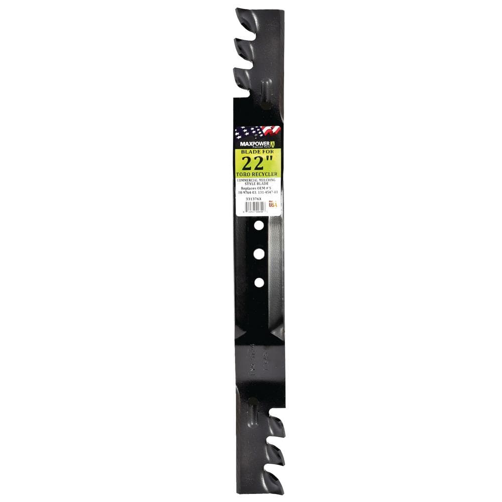

The points not covered in your answer:
specialised mulching blade or not?
Clean out the whole fuel system....(ethanol gas problems? in high humidity environment)
check/clean carb bowl;
check/clean jets for partial blockages?
New sparkplug?
Air filter clean and flows air? (not oil contaminated by blowby or tipping mower during deck cleaning)
Can you trial a replacement mower to see if your grass is just too much for a similar/same mower?
That should also answer your query re stepping up the horsepower/brand you really need to be satisfied...
