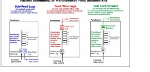

Looks like this is one of those figure-it-out-yourself posts, so here's the follow up.
Helped that I asked me actual electrician.
He said "any panel with feed through lugs"
Course, I didn't know that panels came in lug categories, so here's what I learned..
servlet.ImageServer
Looks like all of the Siemens "P" panel series can accept feed-through lugs as an option. Lug kit for 200A AL wire: MLKA1A
