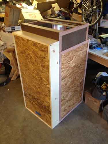

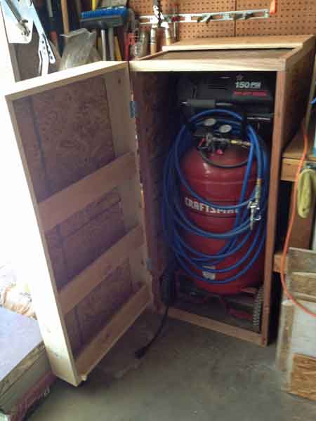

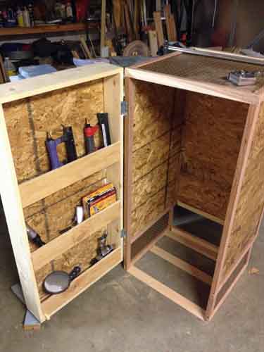

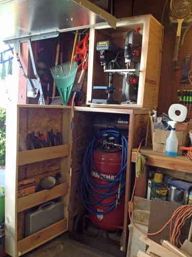

I've built the cabinet the OP describes, but its lower sides and top are pegboard. And while it's cut the noise substantially, it's also trapping heat. But I don't use my compressor for hi-flow tools. So it isn't much of an issue. If I do anything prolonged like using a sander or die grinder, I try to limit the duty cycle, interrupt its use and do other things so the compressor doesn't get too hot.
I've been using this setup for just over 3yrs and it's working ok for me.
The only other thing I'd consider is some egg-crate style foam on its back wall and inside the door.
