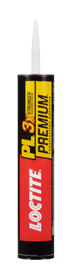

I've bought rubber stair treads to go on the wooden stairs in the garage. Those stair treads are painted wooden 2X12 material. I want to glue them down so they stay down.
I've tried contact cement and outdoor carpet adhesive, both to no avail. The stuff doesn't want to stick to the backside of the rubber stair treads. and yes, I cleaned them with solvent to remove the mold release agent. These are the treads I'm dealing with.
So, what kind of adhesive would you recommend.
yatg
Aug 16, 2019
2,763
Southern Oregon
Try PL Premium. Can get it at most big box stores.
Never tried it on rubber, but it sticks to everything else. Wear gloves.
Would squeeze some out, spread with putty knife, put big flat weight on tread for 24 hours, like a piece of plywood and a bunch of bricks.
This stuff was on sale on Home Depot last week for less than half price. Check the thread in hot deals if interested.
