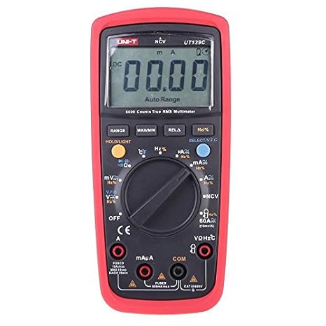

I'd suggest taking a look at a Uni-T UT139C (you can find it cheaper on eBay sellers in China).
It will do what you want, has decent input protections, and won't break the bank. If you need to measure current past what it's rated for, use an external clamp.
