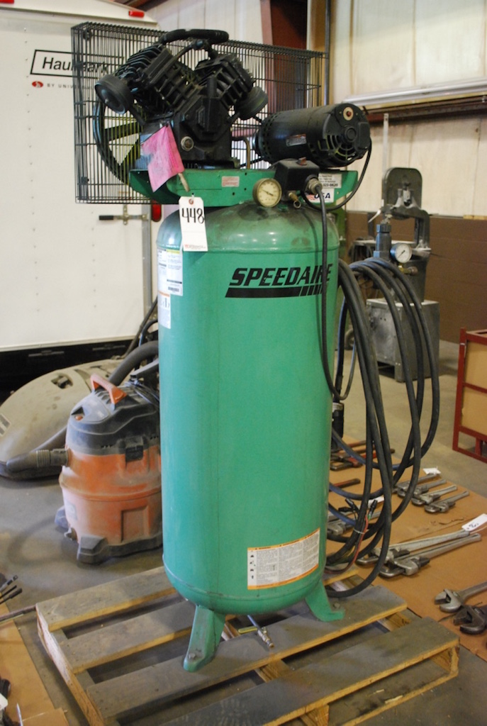

Of course it can be done. Tell your friend to go to the nearest Grainger with a pickup truck--one that has a hydraulic lift gate--and pull out his credit card. They'll be happy to fix him up. All it takes is money. Don't go to Home Depot, don't go to Sears, don't go to Pep Boys, go to Grainger. He'll get a great compressor. Then get a plumber to run some neat air lines in the garage. Maybe build an enclosure so the compressor noise isn't too loud. And it will be 220VAC, so he'll need an electrician to wire it up right. When done it will be a thing of beauty and it will definitely get the job done.
Grainger sells quite a few different Speedaire and Ingersoll Rand compressors. They have several that will pump to 135 psi. Stay very far away from anything Chinese.
You want something like this:

And as an added plus he'll be able to power up a sandblaster if he needs to.
But I don't know of any small compressors what will power up to 135 psi.
