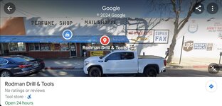

So for the sizes, do they drill on size fairly close? Just looked up Rodman, apparently they're local to me but I have never heard of them before.
darkzero
Oct 20, 2011
3,341
SoCal
Hmm, well that explains why I've never noticed the name on a building before.
