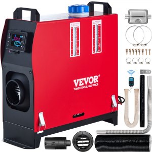

Search for diesel camp heaters. They require 12 volts DC to run.
Here's a link to a video for one of them. There are lots of videos on youtube about these heaters.
And here's a link to the one in the video.

The diesel heater looks interesting.
