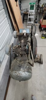

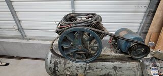

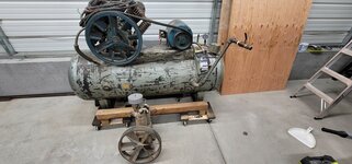

Hi,
I recently purchased a 1961 Washington compressor used. It needs a little well a lot of love. It has a large 200G tank and a massive pump on it. I cannot figure out the make of the pump nor the HP rating. Currently it has a 5HP motor that just seems way too small for it.
Any help identifying the pump so I can get some spare parts or where I should start would be awesome.
I also have a large 3P i believe 7HP grinder that I picked up. Need recommendations on what wheels I should replace the existing ones with as I do a lot of metal fabrication.

For the compressors, the big one looks like a Saylor Beall 707. The small one looks like a Champion R15.

The Saylor Beall 707 is showing as a 10hp compressor, should i order a 10hp motor and see if it gets it running?

These 707s were also packaged as 7.5hp units. If the RPM is correct for the motor size you don't have to do anything. The pump should be turning 650rpm @ 7.5hp.

I can run a 5hp motor with a 7.5HP unit. How do I know which one I have?
This has been my Achilles heel as of late. I have been so frustrated by it.
Here is a video of it running of a 5hp Motor. Yes, the belts are loose, trying to figure out how to get them tight.

I have a 5HP motor right now. Do i need to upsize the motor to a 7.5hp or larger to match that size pump.
You might be able to squeak by with a 5hp motor if you can keep the rpm high enough to ensure proper lubrication. Generally speaking you need at least 400rpm or more to keep a splash lubricated pump happy, but I DO NOT guarantee this will work for every splash lube pump. You might not get much pressure out of it before you are drawing max amps on the motor. I have seen a DeVilbiss 445 (15hp) running with a 7.5hp motor in HVAC application. It was running very slowly and did not produce much pressure but it did run ok. It is a bit more than slash lubricated though.

I don't know how I missed this thread. Saylor-Beall sells a 707 pump compressor with a 5hp motor PL-737-80. My compressor runs at 455 rpm and is super quiet.
Mine is pressure lubed though...
