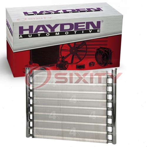

If your worried about the air drier expense you could add a Hayden 1290 cooler to remove most of the heat from the air before it hits the Hankinson., Looked up the manuals and the Hankinson does not seem to have a pre-cooling coil, thus the Hayden DB1290.
