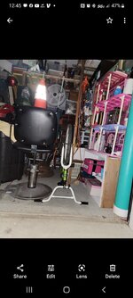

Hey ya'll. Im in the process of making suspended platforms for my storage unit (corrugated metal). I feel like I'm the only person to have ever wanted to do this. Which is crazy to me!! I made a whole canopy situation/raised bridge out of wood in my last unit and the legs had to ne in the middle of the unit...so they were in the way all the time. So i decided to make a suspended one this time, BUT....im not supposed to put holes in the unit (even tho i will def have to make a few). What shud i put into the metal to hold the chains that hold the platform-that holds my totes?!
*idea 1: make the smallest holes possible to get a toggle bolt thru the metal and have an eyebolt instead of the bolt thats normally attached to the toggle?
*idea 2: hallow wall anchors?
☆Ps-ive attached a photo of my old storage unit thing i wax talking about above....its really hard to see it tho..
Any help will be GREATLY APPRECIATED! thanks n happy 4th

Corrugated metal in a self-storage unit is NOT engineered to hold suspended shelving. It's typically 29 gauge cold-rolled galvanized, too thin to hold a screw or support any appreciable load. Most are engineered to the ragged edge to start with; it's a cutthroat business.
Anything you screw into it will compromise the weather tightness and/or the adjacent units. Not what you wanted to hear but the fact is you shouldn't be attaching anything to the walls or ceilings of a rental storage unit. Build freestanding shelving if you need stacked storage.

What do u mean 'custom shelving without a support leg?' Bc if i cant builf anything off of the storage unit walls (bc it wont support any extra weight some1 said)....then no matter what i build....will have the dreaded legs. Im attaching pix of inside my unit.20220705_230534.jpg20220705_230546.jpg

You could use beam clamps and threaded rod to suspend stuff with Unistrut and other hardware.
That stuff isn't exactly cheap at retail stores.
Then there is the issue of being responsible and not putting too much additional weight on the structure.
Free standing shelving eliminates these problems.

Before you go too far attaching anything, please dig out your contract and read it to see if there is a clause specifically forbidding attaching anything to the walls, roof, or framing. I would not be surprised if you found out that it is not allowed by contract. In that case, anything you do attach you run the risk of defaulting on the agreement and getting thrown out.
That framing is pretty light and spaced out pretty far, I wouldn't hang much from it. You may not like legs, but there are many options that won't consume much floor space.
